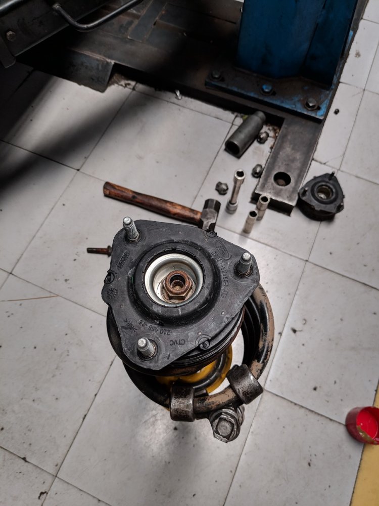

Suspension Mounts :
During the last Ponmudi hill run I started noticing a strong metal clunk sound while coming downhill. I initially thought something was not tightened to the correct torque spec. It indeed reduced my confidence as I was pushing it hard around corners. I was pretty sure that the sound was not there when I was climbing up hill. The thought of something not properly tightened slowly creeps into my mind. Stopped by to see if any visible changes inside the engine bay to which nothing unusual was found. Later, I found out that, once after braking and hard acceleration is when this sound comes in. Again the thought of something not properly tighten was striking me badly. Then I remember while I was installing the suspension I saw a small crack on the Gearbox mount. I thought that it gave up so fast which made the sound. Finally relived a bit by assuming that I find out what was wrong, I slowly returned back to home. Got an appointment at Harry Ford the next day.
First car in for the day!
Nearby lift so that I can keep an eye on the car, these guys are really friendly and helpful.
After lifting the car, came to the conclusion that it wasn't the gearbox mount, Tension intensifies![shock]
Suspension Mount was the culprit. After checking the car again and again, taking it for many test drives, we concluded that it should be the suspension mount. The service advisor's Prem & Athul Murali was very sure that this must be the only reason. Since I was very much worried and I wanted to fix this issue, asked them to swap both the front suspension mounts with my finger's crossed. The mount comprises of two parts :
Top Mounting
This comes under the Top mounting.
Part numbers for reference. Price as well.
New mounting put back together!

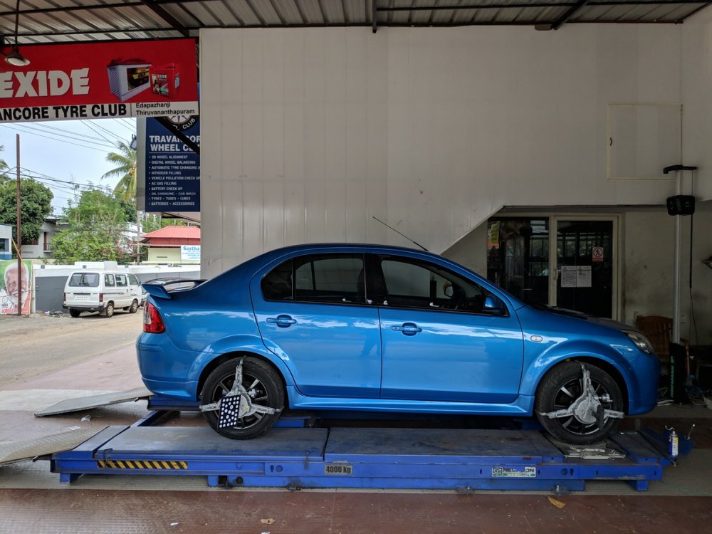

The problem was solved and got the car in for an alignment check since both the front suspensions was removed and fixed back. [drive]
