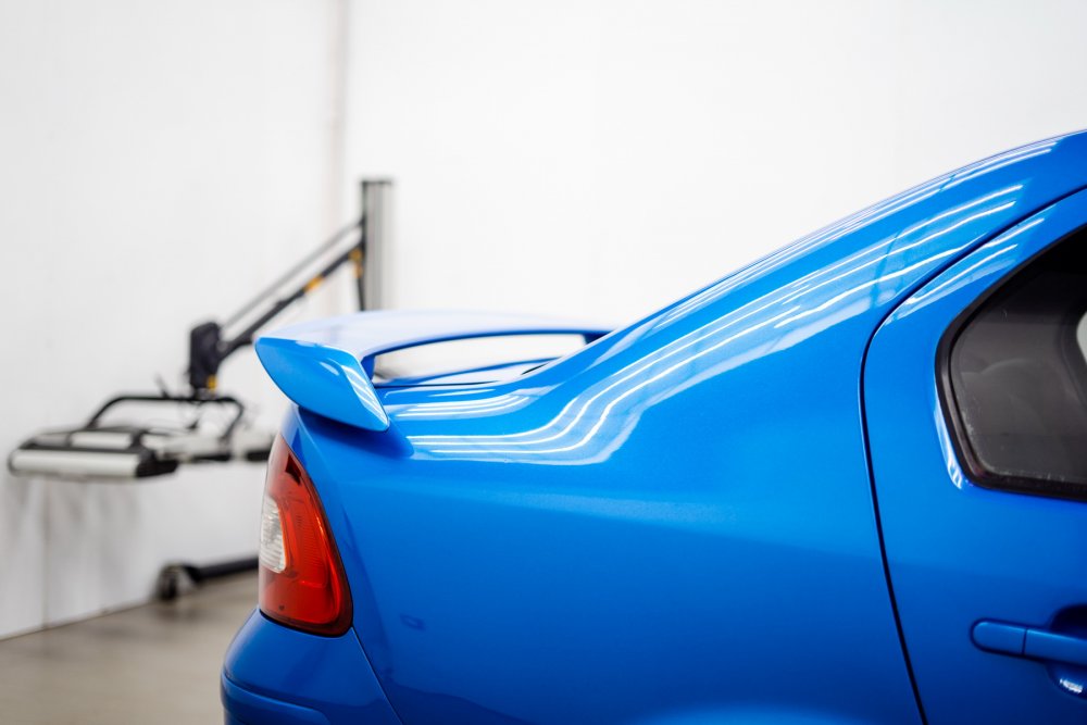

Hey everyone, it's been a long time since I've updated anything here. Ton's of updates are pending to be documented here. Will get it done in this Quarantine Days. Got the Ceramic Pro'd from the best guys in Kerala.Ceramic Pro Kollam- InDetail. The owner of this firm is an old friend of mine and is still maintaining my Amaze from the initial days. Amaze was protected 2 years back with a custom layer coating. This time we thought to go for a 3 Layer Package from them. Costed me somewhere around 35K. The whole process took around a week since I opted the coatings to be cured naturally rather than using an IR blasters. I felt this was a much more better way to cure the coating evenly and naturally. As I know him personally, I didn't rush and took the car a week later after they completed the whole process. More than enough healing time.:stupid:
Attaching pictures along and as a cherry on top attaching a video link from the Ceramic Pro Kollam Team.[cheers]
PS : I'm not anyway part of the Ceramic Pro Kollam Team, they did an exceptionally good job, so thought of appreciating them.
Pro's :
  • Much better than a Wax coating.
  • Doesn't fade away as it ages.
  • Extremely easy to maintain.
  • Bird droppings won't leave a stain.
  • Tar won't stick that easily.
Con's :
  • Whopping 35K INR for this package.
  • Time taken for the procedure.
Ford Fiesta 1.6S Ceramic Pro

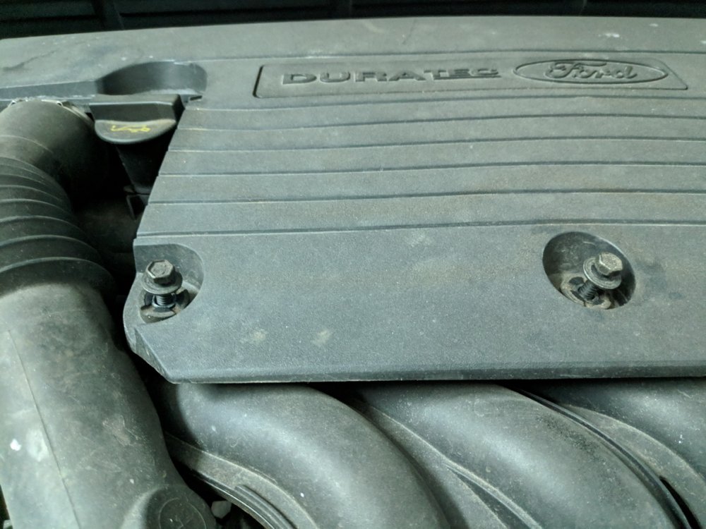

K&N Stock Replacement Filters
Was running with the stock setup for a long time and the itch for more power has been begun. Finally as a kick off, tried sourcing a stock replacement K&N filter for the Fiesta. Costed me around 7K. These life time filters are made of cotton material in comparison with the way cheaper paper filters that comes as OEM. These filters are supposedly having more air seepage comparing the stock ones. The fitting process is the most painful task.
Unbolt these two bolts on top.
Remove the piping lock. Just twist and voila!
Remove the metal clamp
There will be two rubber lock, just pull it out and the whole air filter box will come out. You will be welcomed with 10 long bolts that needs to be unscrewed just for replacing the filter.[frustration]
This is one of the major reason why even service people are lazy enough to change the air filter. In my Honda, unlock 2 clips and that's it. I really wonder why would anyone come up with the idea of putting 10 long bolts on the air filter box that too should be changed or cleaned in my case at every 10K kms max.
Without the AF box
Stock air filter, pretty clean.
K&N Filters, come pre-oiled.
Was too lazy to clean it anything more than this, was running late as well.
Voila! Fit's in perfectly.
