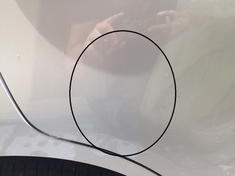

Ok so my problem doesn't seem to go away. After the scratch problem which I have to overlook,here comes the mother of all problems. The body cover which I used to cover the car has left blue spots all over the car because of rains. The colour has bleeded and dried in sun over the car. It's like a blue film over the car everywhere incluing bonnet.. where the water has flown in a line, the original Color is there. so where the blue water got a chance to dry it is blue mark. So there are ugly marks of clear silver lines and blue film all over. I tried washing it off with armorall heavy duty wash. I am not sure whether I am able to lighten them or not. Tried megs UP which I got recently using a MF and wipe it off on a small area but no success. I am so much pissed and sad at the same time. what should I do. Should I just wash it and wax it with cleaner wax and leave it in sun for some days. Will the colour evaporate automatically after 4-5 washes. I think it is some dye used in clothes.

Oops, thats a serious problem. Megs UP should have removed it easily but surprisingly it didn't! Try Scratch remover, IPA or even kerosene but don't let it dry, wash the area with plenty of water and shampoo.
If these products doesn't help then blue marks aren't above the paint surface but mixed with the paint. Though I cannot say for sure without seeing it. I hope it goes away with several car washes but just don't wax the car until the paint is perfectly clean and I think sun will only make the issue worst.
I hate these car body covers, they do more harm then good. From where did you get the car cover?

Thanks cracing. I think I am able to fade it a little with washing the whole car. Though it is still evident and I may have made only a small dent in the whole mountain which is in front of me. I hopeit will fade away after several washes. My wife says there is little to no improvement. Then I asked do you see it is purple now instead of blue. She agreed. This is what gives me hope that it is turning and clear away with several washes.
When I said cleaner wax, I meant it to use as to clean spots and film. I read yesterday that cleaner wax is an all in one products that has polishing ability. So it is used as a stain cleaner and protector at the same time. I tried it and I think the spot has faded a little. Same is the case with megs UP. I have nulon cleaner wax. Do you suggest using it on full car. At least it can protect the car from daily dust and weather until the Color is gone and car is ready for detailing
Regarding the cover, I bought is from a local shop and it is the only type of cover it sells. Blue Matt cover it is called. I have used similar cover for my swift in the past but never faced any problem. Found one more instance on team bhp where somebody faced the same situation. Unfortunately the guy has not posted how he solved the problem. Here it is.

Sorry for the delayed response as i was ill from couple of days. Here are the pics, I don't know how much you can make out from the pictures with reflection.
I took the car to the acr accessory shop where i bought the cover. showed the car to the shopkeeper, he was also shocked to see it. he told me this is the first time i am eeing something like this, there was no complaint about the cover in the past. HE took the covr back and offered me the service to remove the stains by rubbing compound. he said come on a sunnier day and he will get it rubbed. HE also said this stains will fade over time and not in day or 2 if I am not ready for rubbing the full car. He said it may take 1-2 months for the stains to fade away. I am scared to get the full car rubbed with a rubbing compound as it may dull the finish,experts please comment what to do. In pics you may notice stains as the color is more in that area but there is blue/purple sheen all over the car which I can see being an OCD
On the car cover front, he has sold me a new car cover which he claims to be 100% waterproof and far better in quality then the first one. It is 4 times the cost of first one and he has guaranteed of no problem like previous one. I can feel the difference in the fabric quality, belt & buckle quality, has antenna pocket and looks premium than the first one. Lets see how this comes out to be.
