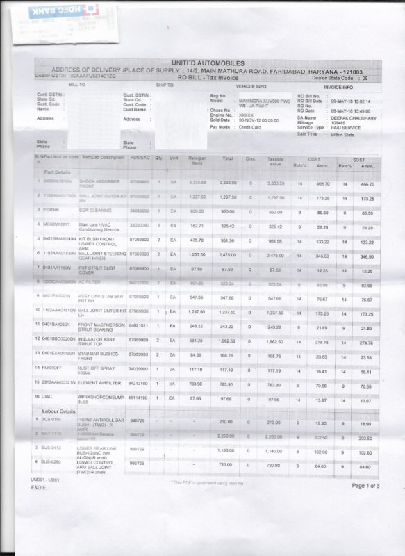

Total Damage done:
Rs. 15,3147 /-

Copy of Bill attached.
