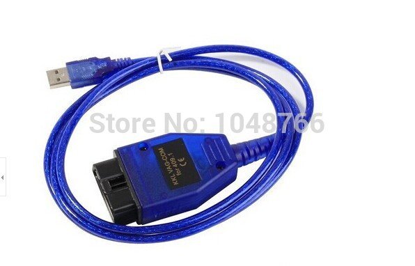

Friends,
I came across an interesting article that shall be helpful to those who own Skoda, VW or Audi passenger cars here. It is mainly about a Diagnostic System that works mainly for the above mentioned cars. It in abbreviation is called V.C.D.S i.e Vag Com Diagnostic System. VAG-COM is a Microsoft Windows-based software package that has been developed and produced by Ross-Tech, LLC since May 2000.
Usage Of Vag Com Diagnostics System.
VCDS shall perform most of the functions of expensive electronic diagnostic tools which are available only to Authorized Dealers like the current VAS 505x series diagnostic tools. In the past, these dealership-only tools have prevented owners, and many small independent repair shops from performing some fundamental tasks, such as diagnosing problems, diesel ignition timing, modification of convenience options such as automatic door unlocking, coding a replacement electronic control unit (ECU) or key to the vehicle, and monitoring of many vehicle sensors for diagnosing problems.
Unlike generic on-board diagnostics (OBD-II or EOBD), VCDS uses the more in-depth Volkswagen Group-specific manufacturer protocol commands, which allows the user to access all diagnostic capable vehicle systems even in vehicles which are not covered by generic OBD-II/EOBD (e.g. pre-1996). In general, there are two ways to use this software, either as a package (software and hardware) distributed by the manufacturer or their agents, or, by building your own interface hardware and using it with the publicly available but limited shareware version of the software.
VCDS is also capable of interfacing vehicles which use the generic OBD-II/EOBD protocols. However, the OBD-II and EOBD standards only allow for limited diagnostics, and no adjustments to any of the ECUs.
source
source 2
*Pics from google.

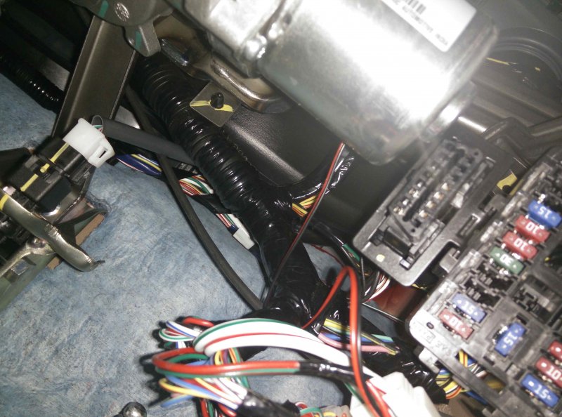

Hi All,
i'm new to this forum and cars as well. I bought a new alto 800 recently and stuck with some issues. I can't find ODB connector location of new alto 800. I have a OBD 2 bluetooth device and i like to see insights of engine performance. Can someone please help me to find OBD connector location in new alto 800.
Thanks in advance. [:)]

Generally the port is located below steering wheel. Its generally not visible openly. So better look closely you will find.

I tried to find it under steering wheel but still no luck. can it be under the hood near fuse box ? [confused] If someone with new alto 800 please post a picture with the odb connector location if possible.
Thanks..

I don't have alto but in my Wagon R it is located under steering wheel. Please see pic below for your reference, may be you will get some idea.

Thanks for the replay. I finally found the port. IMO new alto 800 build quality is really bad when it comes to electronic arrangements etc.. I'll attach a picture where i found it. It's hard to reach and I can't even directly plug odb connector due to lack of space. wangonr seems to have everything arranged nicely compared to alto 800.
