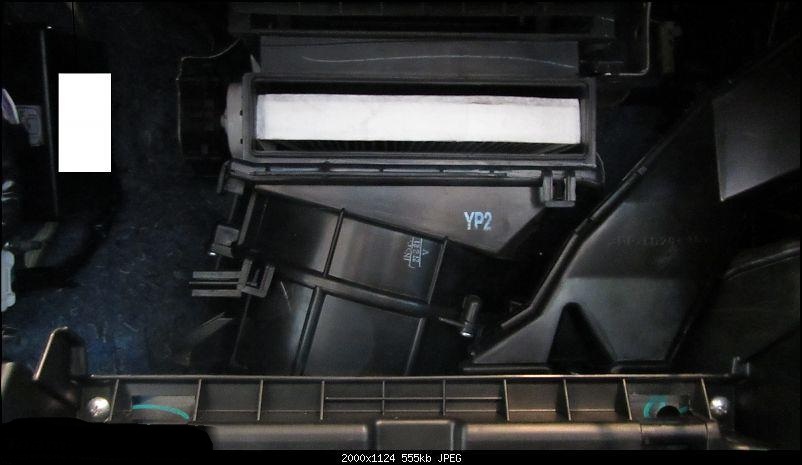

Well most would be surprised to know that the Air Cabin filters as not provided in any of the Maruti Cars .....probably in any of the Indian Cars .... I was even surprised to find that even in the US some of the cars do not provide the Air Cabin Filter.
The location for the air cabin filter in the Maruti Cars is behind the Glove Box. So you basically need to take the Glove Box out or some how access the Air Filer Location.
Here you go with the process:
This is the same process given in Team Bhp as I took the details from there as it is very cumbersome/tricky to actually fit back the glove box.
Please note that after the Filter is installed you need to put the Black cover back i.e. after the third pic.

Thanks For sharing the pictures. But am not able to undestand the angle (view) of picture taken. I mean is this from bottom side (camera facing sky) or from front side (you sitting in front of glove box).
