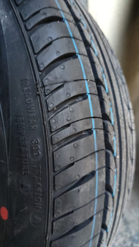

In the meantime I managed to procure 5th new tyre. Same brand but increased price. I am satisfied with their performance.
I already purchased 4 new tyres back then at the start of ownership. At that time budget constraints allowed 2 only. But still, somehow bought all 4 new. But 5th kept lingering in my mind. It was 11years old you see !!
So now all 5 are new .Lucky, I got a fresh badge. Manufactured: July 2022
Just a comparison with huge Nexon tyre.
Just a comparison with huge Nexon tyre in the background
Good brand + economical tyre+ decent performance.
OEM recommended specs on OEM rims.
I like the tread pattern.
