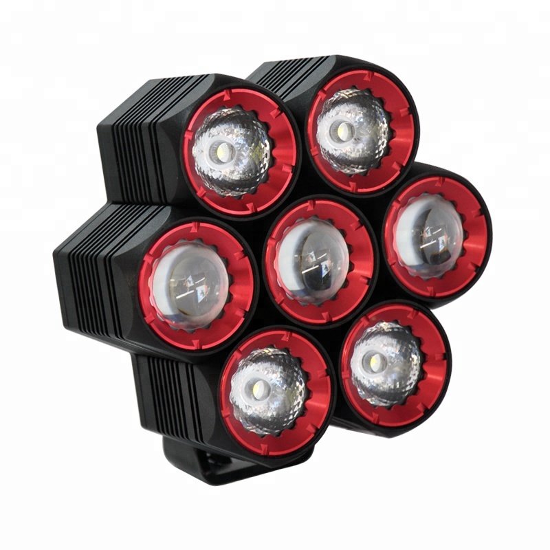

Hi All,
We have added few exceptional quality range of products and would like to know everyone's feedback. Main feature:
- 5 degree Super Spot Beam/10 degree Spot Beam/20 degree Flood Beam
- Genuine 20W CREE XHP50/ 10W XML U2/ 2 x 5 Philips Lumileds LXZ2 Led chip used
- High Grade Aluminium 6063 Housing with Anodized surface for keeping led cool
Model Details:
1- Modular LED Pods - X1 10W 1000LM Smallest Pods - These pods can be used to build 10-50 inch led light bar or Work Light
2- Modular LED Pods - X2 10W 1000LM - These can be used to build 6-50 inch led light bar or Array Lights or even Dual row LED Light bar etc. Very flexible.
3- Cube Work Light 40W 4000LM Super Spot beam with Real Testing Images - Two options - one with 2 x 20W CREE XHP50 LED with Single lens another with 4 x 10W CREE XML U2 with 4D design and backlight
As per the spec below is the beam pattern along with Lumens power.
4- 18MM Thick Slimmest and light weight LED LIGHT BAR - 10 inch to 50 inch
Do share your feedback. [;)]
