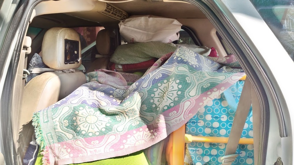

As usual, I was loaded with crap ton of Luggage-
BzvN9yFuuJZlw4fyFCjVqkp2sFwz9X6RuEr2C1WsL4kAfaPG4fmTKBP3g0q1NWsMn_2quXNSpceWx8xGoD=w1167-h656-no.jpg
nYqT4MAexopcMkNE6HVUwq9OamjlM372K-P1JDojY8363fcTNVPEYYi-8D8Q7Lo9awD3mpmZfUFxgn6bxU=w1167-h656-no.jpg
6I9_TkE174tAVqtjs-lgfU6S6kpWhdm7MJjVhxQBjIC_kpVh79aK00aqmqHeV4TpSsdwYLK5TW-zw23ziM=w1167-h656-no.jpg
The beast is ready and Roaring again. The Beast did about 400KM journey after this and seems to be healthy.
