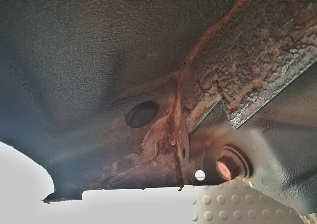

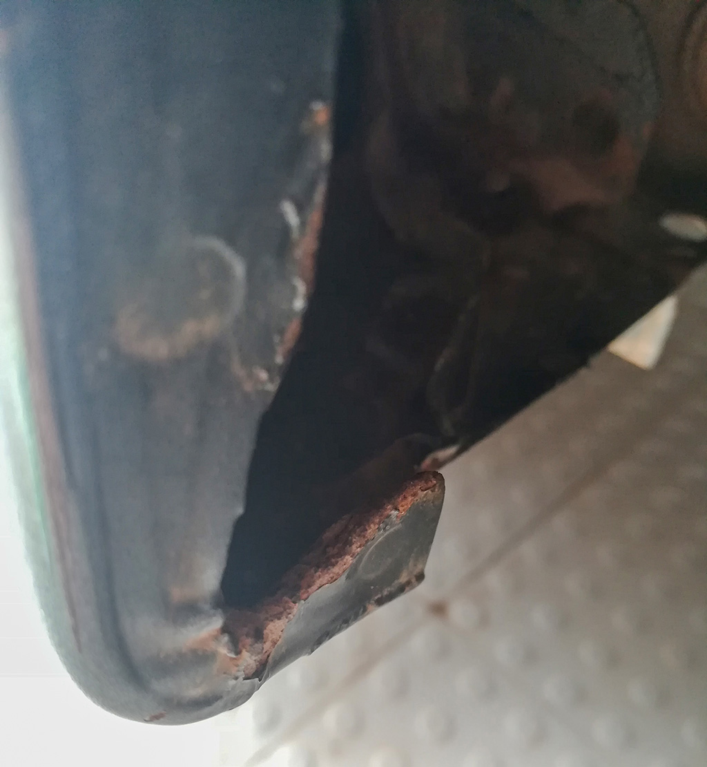

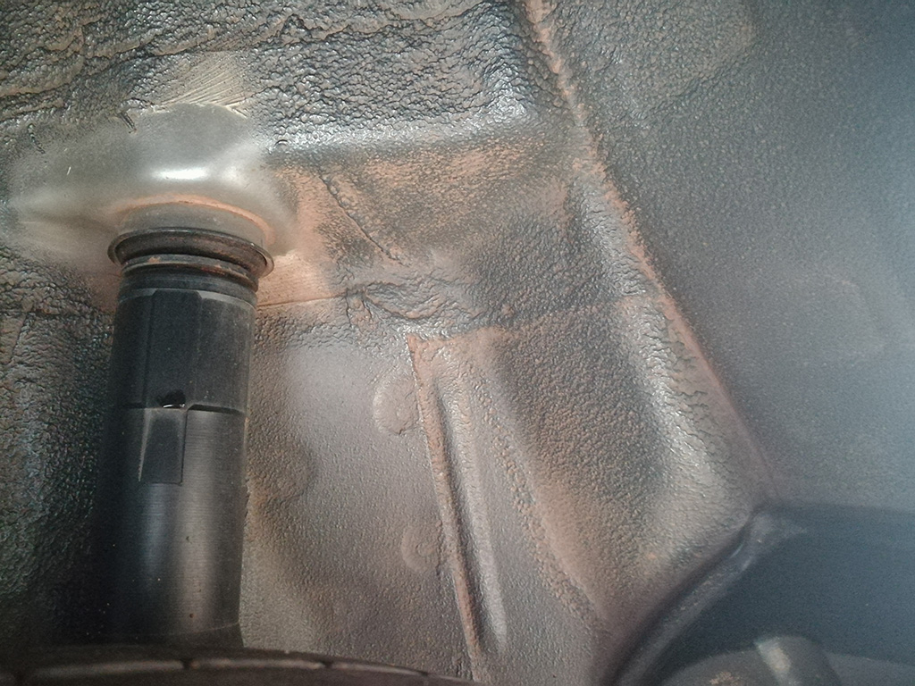

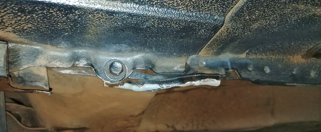

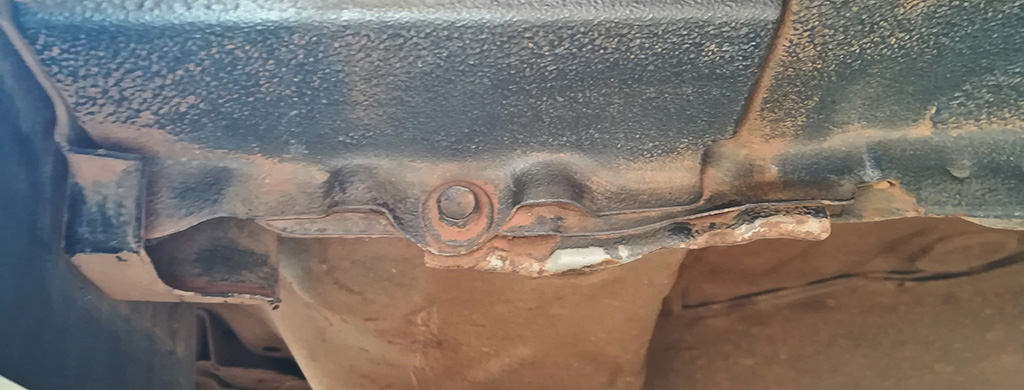

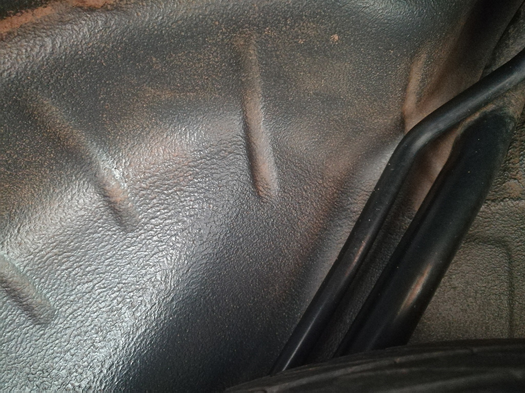

Anyway, Today I have spent whole day cleaning my car underbody running board, wheels, wheel well and etc. It was harder because I didn't remove wheels (Elders are always right) and dirtiest job I have ever done. Took me hours to clean mud and stains, yet couldn't do 100%. Factory coating on chassis is good enough and rustfree but minor rust has occurred wherever the coating is stripped by damages (i.e bottom hits, stone chips).
Next, I have used Krud Kutter The Must For Rust on rusted areas and with an hour of multiple applications, it cleaned most of the rust. Its a wonderful product. Finally rinsed with clean water as instructed.
Factory coating on wheel well:
Before:
After:
Tomorrow, I will reuse rust remover and get rid of more rust, then I will use RC800 on wherever there was rusted.

Well done task on free sunday. Thank you for your kind words.
As regards, Zinc Chromate I did read that it is not used in USA. While spraying or applying one has to be careful and cover the face with mask. So also while applying any other coating. one should use hand gloves, mask, safety glasses and cover the head too. In India and in other countries it is still used for ships and also in all Refineries and Chemical plants as primer because it gives better protection to the base metal. Once it is dried ( within 20-30 minutes) it is like a solid coat on the surfaces. of course 2nd coat of rust proofing painting is done in the plants. Majority of Refineries, power plants n chemical plants use Zinc Aluminum coating ( very expensive) for protection as well as for better look too.
I see some rusting and corroded points in the photos you have attached. Once you clean and remove all those rusting points, protection to be done at the earliest by drying , otherwise moisture during the monsoon will again attack those spots. Pls do also check flooring by removing the carpet. You can use a big mirror to check any rusting points at the underbody. Because chasis and other MS components are the areas those develop rusting.
Good luck to you.
