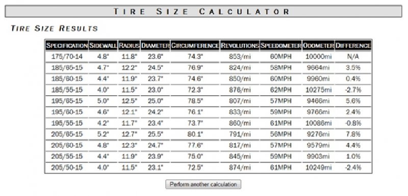

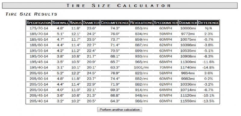

Buddy hope this will be of some help to you!
Your stock tyre size is:
175/70/14
So if you wanna upgrade, I have calculated through the tyre size calculator, the most preferable upgrades![surprise]
14 inchers upgrade
185/65/14
195/65-14
195/60-14
205/60-14
15 inchers upgrade
185/60/15
195/55/15
205/55/15
16 inchers upgrade
185/55/16
185/50/16
195/50/16
205/50/16
205/45/16
Minor difference will be there in the spedo meter reading of around 2-3kms up or down!

Thanks gears, its certainly helpful.
Can you suggest how "195 / 60 R15" would be? This is the E-Pack, OE tyre size.
Yes RSM you can upgrade to those which you mentioned also as your Punto is designed by Fiat themselves , and so there wont be any handling or suspension problems. Only marginal decrease in FE and also slight speedo error.

Does rim size (Punto has 5.5j) matters for deciding the width of the tyre?
Definitely. The rim width decides the max width of the tyre you can use. If the rim size is inadequate, you will have your sidewalls bulging on both sides of the rim. This will not only result in lesser sidewall strength, it also puts undue strain on the sidewalls. The other disadvantage being, you get lesser contact patch available.
For the Punto, the bigger problem is the PCD is 98. Which makes it extremely tough to get good alloys if you want to go for 195 width or upgrade to 15s.
Suggested upgrades would be:
185/65/14
195/65-14
195/55/15
I haven't checked the error in OD on these, but as long as its under 3% you are good to go. Anything below 55 profile or higher than 15" rims is suicidal on Indian roads.
