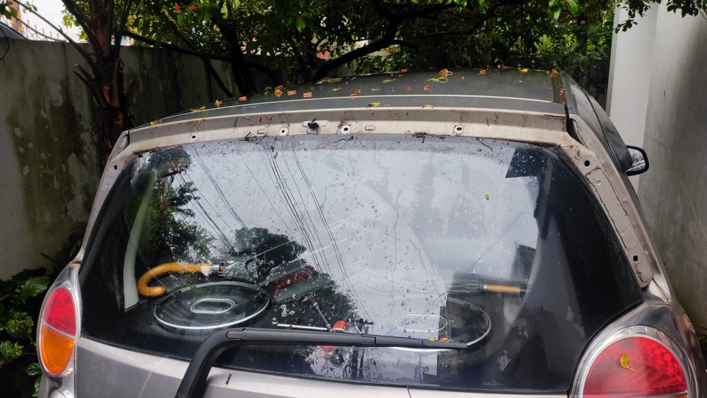

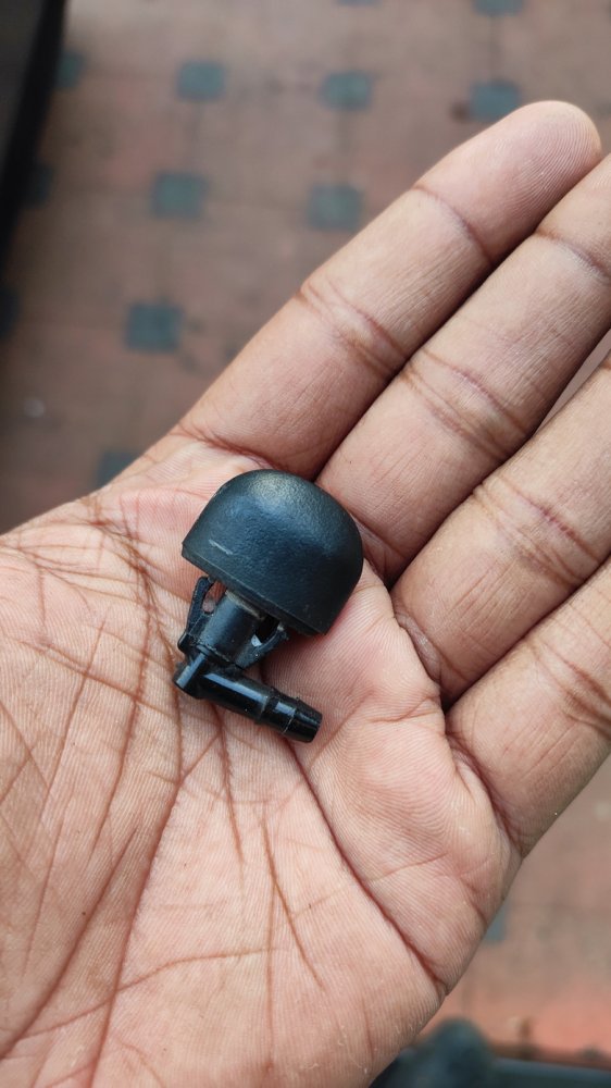

The OE rear windscreen washer nozzle fetched from the scrapyard.

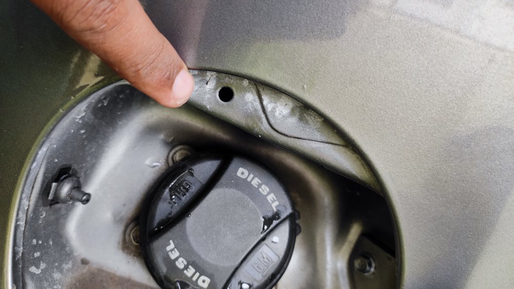

Primered the drill hole edges as @bhvm suggested.
Plugged the gap in the hole with glue stick.

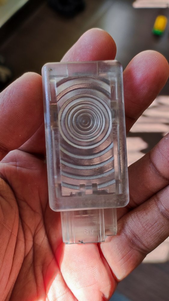

Boot lamp also from the scrap hunt.
Removed the bulb holder.
Clean.

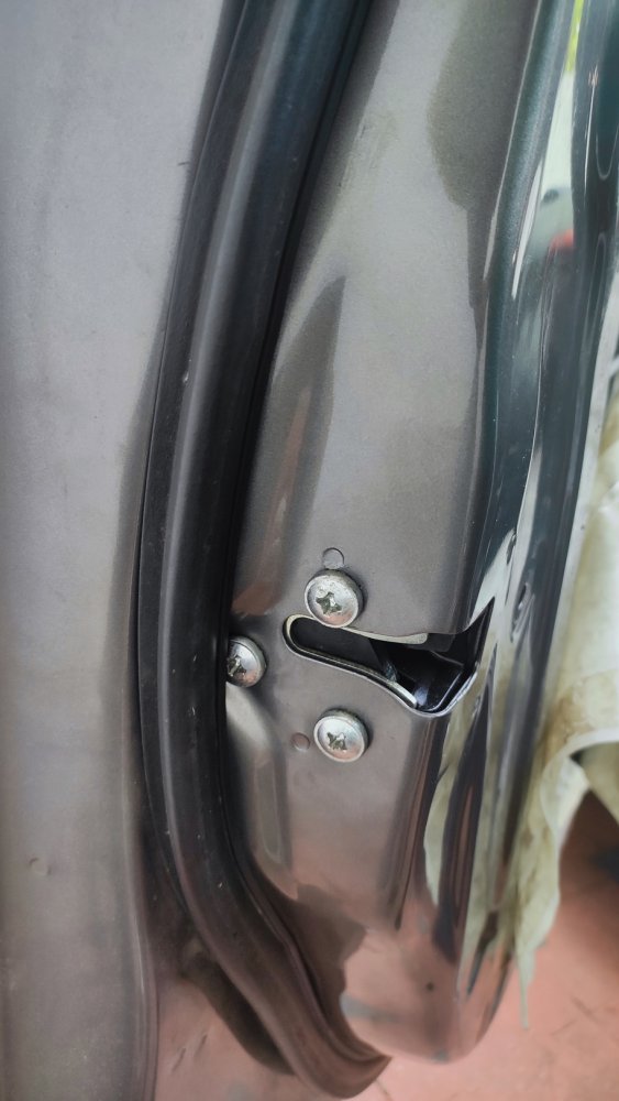

Back to the boot light. Needed a lot of wire. Boot switch was inbuilt to the lock as posted previously. Needed to route wire all the way to the boot bottom.
Connector in the boot lock.
Took ground and fed to the switch. Now, we got a switched ground.
Fed the positive to dome light. Success.

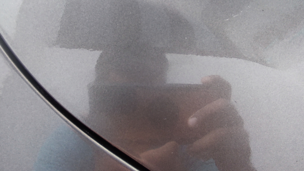

Some scratch removal. The moron-made full-body-length scratch. It would disappear each time with rubbing and polishing, but reappeared.
Tried to source 3200 grit, which the body shop guys used, which was available as big roll only. Settled with 2000 grit.
Sanded gently, not to cut deep into the clear coat. Applied a thin layer of automotive clear coat with pointed brush where the scratches were too deep before sanding.
Removed the haze with 3M compound.
Outcome.

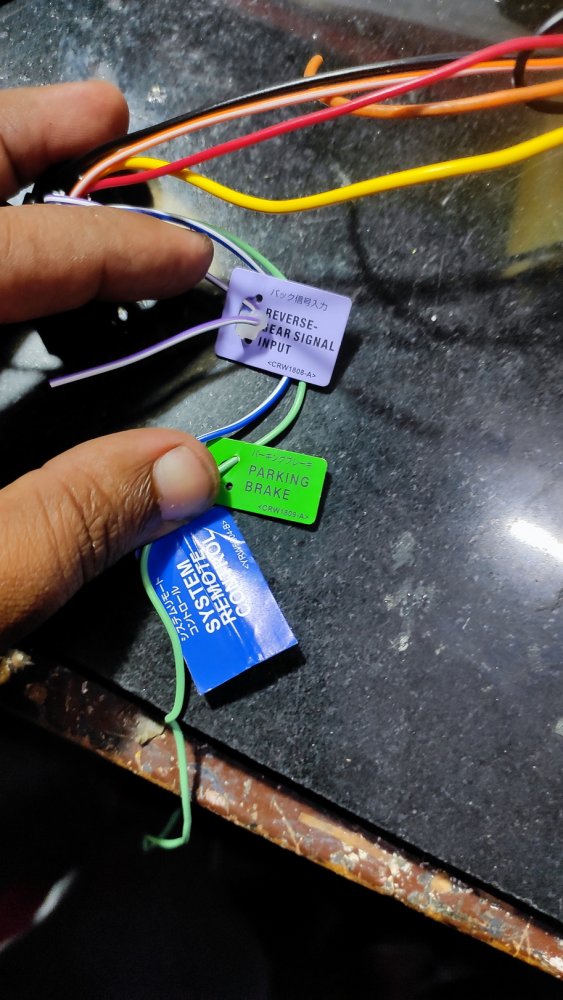

Main connector.
Reverse gear and parking brake signals go into them.

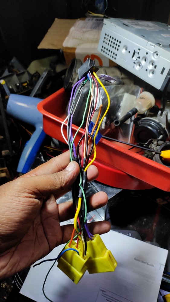

Old vs new connectors. Power input and audio outputs are same, so can operate without rewiring directly.
Main difference being the additional wires for park brake (light green) and backlit (orange/white). Park brake input needed to play videos and backlit input needed to switch light/dark modes/dimming.
On the other side, there is an extra wire for reverse gear input (violet/white) and the remote wire relocated (blue/white).
Install complete.
Face panel needs a bit of trimming to fit.
Coupler to OE connector had a few flaws. Red and yellow were ulta-pulta.
And didn't have provision for backlit, which the OE connector provides. Removed an old pin with orange wire from an old connector and added to the coupler, got exact colour match.
Swapped the red and yellow and mated them with the Pioneer connector, soldered and sleeved.

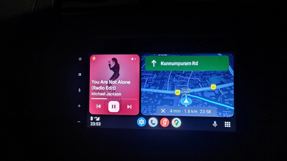

The Android Auto screen. I chose Gaana as default player. Google Maps take up the majority of the screen.

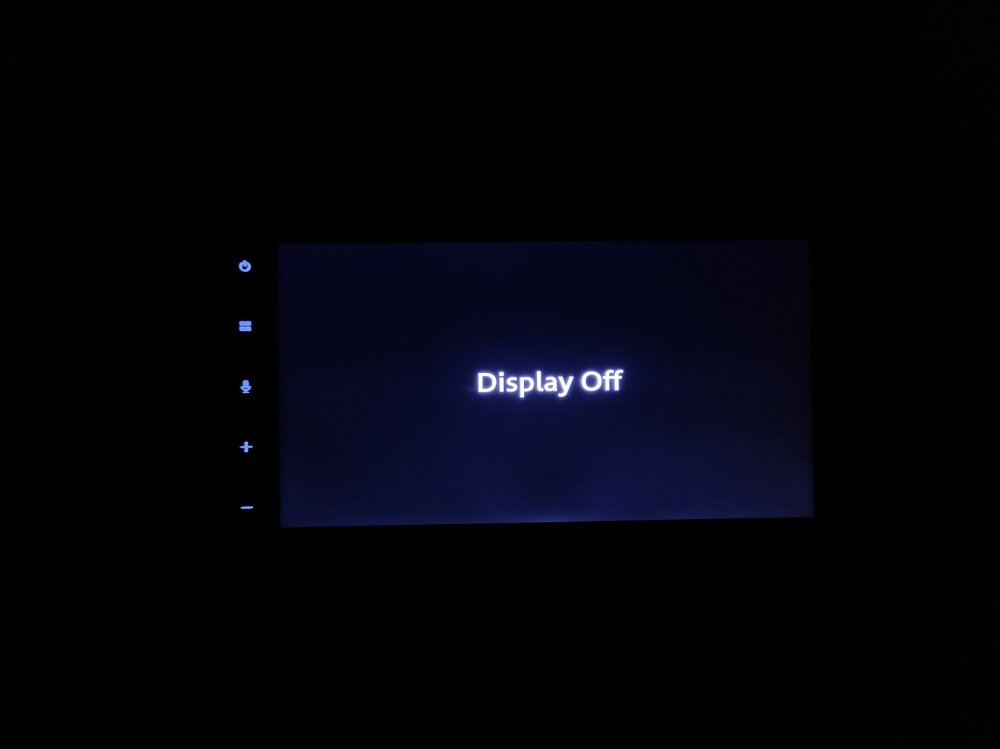

Soft touch of power button turns off display instead of standby/muting. Long press turns off the power. Menu button works as mute with long press.

Connector for the HU.
Reverse gear signal input in the main connector.

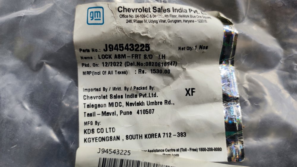

Door Lock (Front Left) - J94543225 - ₹ 1,584.00 (plus ₹ 68.00 shipping)

Remove these three bolts to remove the lock assembly.
Unplug the remote locking connector.
Three rods goes to the lock. These can be undone easily.
Rotate the plastic tab to unlock. Third one (grey) is like a Scotch Lock, just open to release the rod.
New one came with rod for the key barrel. Plastic wheels got damaged with old lock, cause being people trying to open when unlocking. It locks, but won't unlock most of the time.
Key barrel is installed with a 10-mm bolt. Need to remove the barrel to connect. Can be skipped if connecting rod before fitting the lock.
Grey clip for external door handle.
White for internal door lock and blue for internal door release.
Lastly connect the remote locking connector.
Done.
Spotted same Sand Drift Grey Beat with an OE spoiler. End of a long search. The car was newer than mine and was a base model fitted with top model spoiler. Made a casual enquiry and price was decent. Asked ₹ 1,800.00, got for ₹ 1,600.00 without any bargain. Most of the sellers quote between ₹ 3000 and ₹ 4000. Matching colour means I can save on painting too.

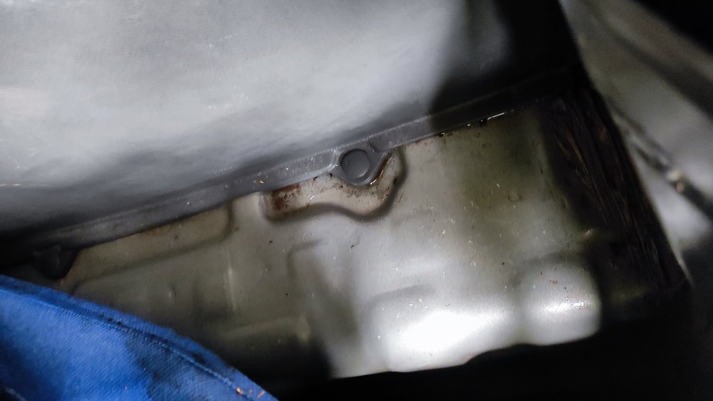

Waterlogging again.
Culprit. Missing grommet.
