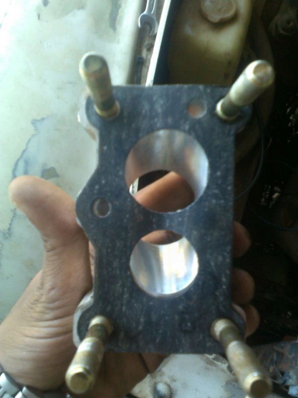

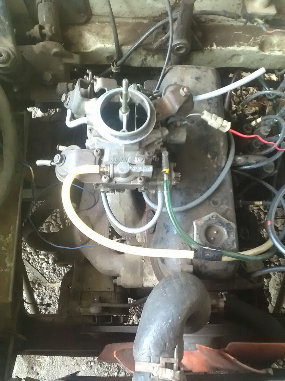

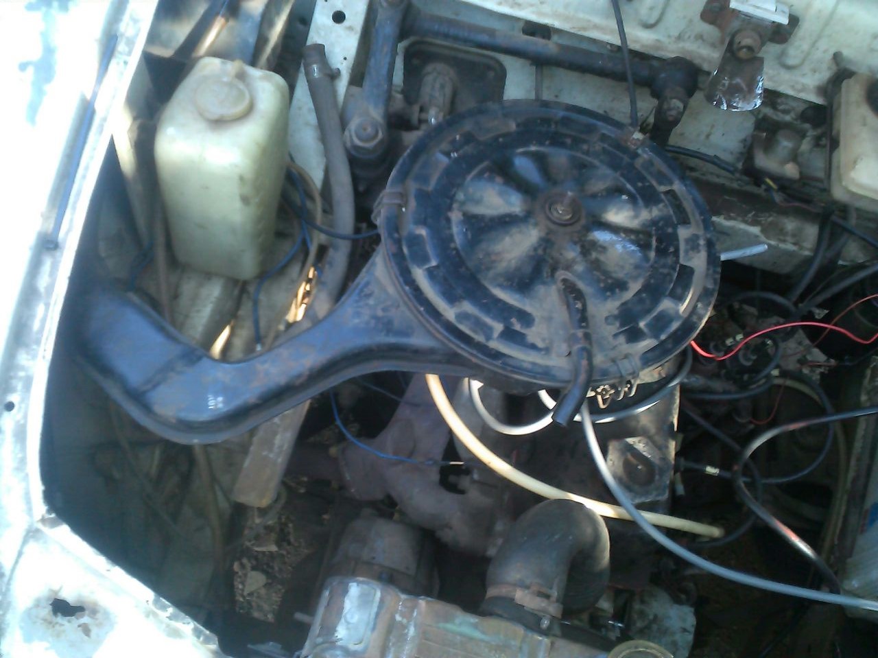

We have a Gypsy Carburetor with us, unused, any possibilities of plonking it on the existing intake manifold. What Jets should I use for the carb if I use another carburetor?
No idea about the Gypsy carburetor. I think it is a side draught carburetor. Else you may try a Maruti zen carb with an adaptor. Attached are some pictures of my friend's S1 which has Zen carb adapted. He is happy with respect to starting, acceleration, though he hasn't tested top speed. Took him 3 hours to do the swap with all parts available with him. Fuel consumption with bottle turned out like 18kmpl, though I presume 15kmopl to be practical. He didn't go through any jet adjustments or changes. Just used the Zen carb as it is.
Thankyou very very much sir, Pics are very helpful, Can I get the adapter directly from market or it should be custom made?
Most welcome. I got the adaptor made from a CNC machine shop near my residence. Paid Rs1300/- for the material + machining. The 6 studs might cost another Rs50/-. Can get you one made, the day you want to go the Mikuni way.
Thanks again sir, I will contact you once I get the Carburetor from my friend. You are like encyclopedia for we noobs to automobiles. :)

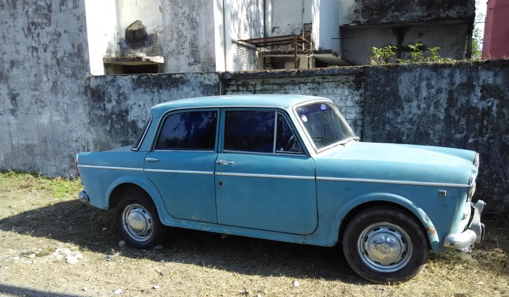

As of now , what we have done to car is as follows:
Tyres - 175/70R14 Rear and 165/80/R14 front
Alternator upgrade from the conventional Dyanmo.
Castrol GTX 20W50 engine oil.
Worked on the wiring and got almost 90% of the lights in working condition.
Rear brake hose replaced with OEM one.
Next thing we are planning is a DIY free flow exhaust. We would also be giving it a custom paintjob which would obviously be a DIY.
Here are some pics of the car...
