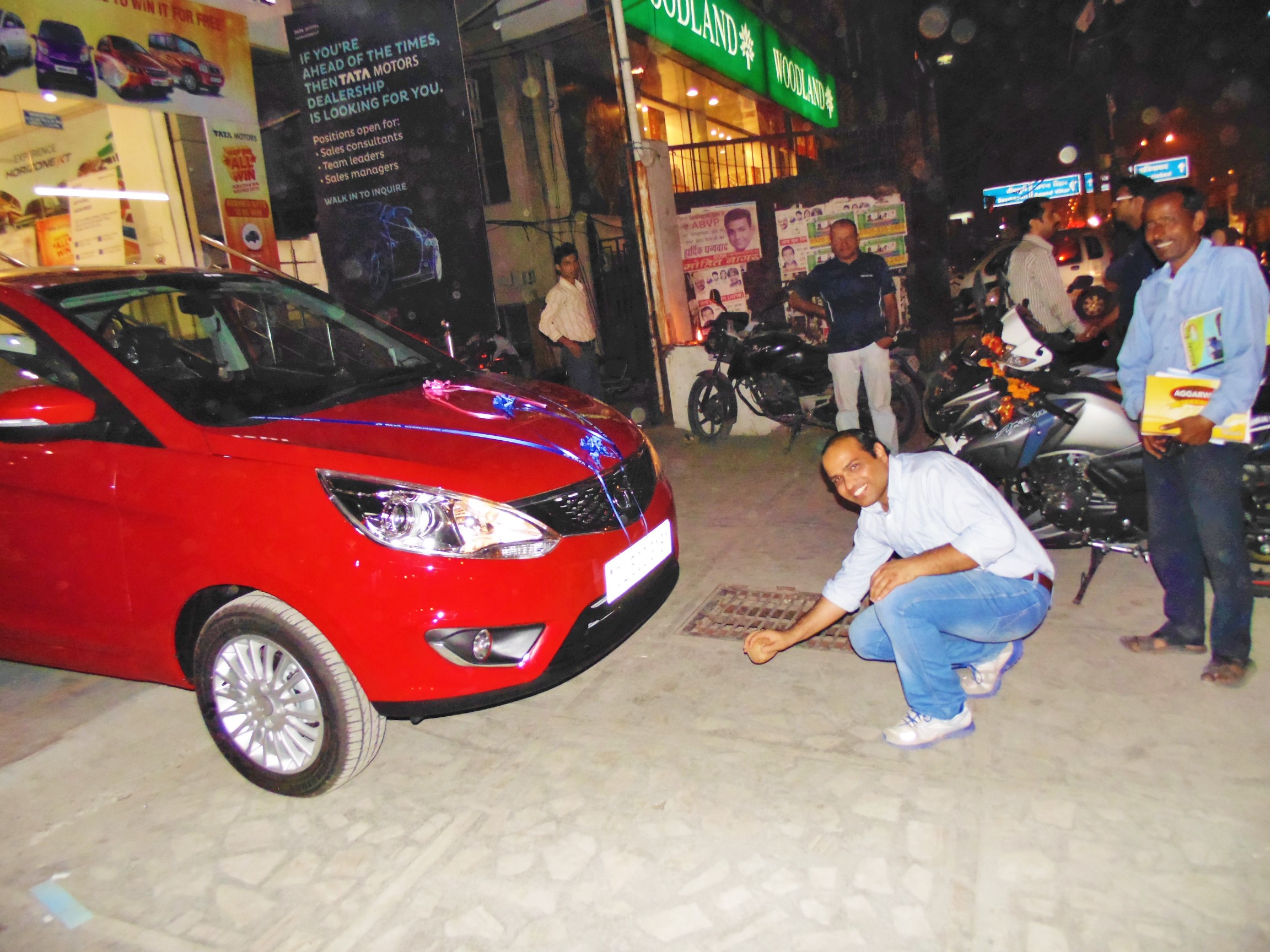

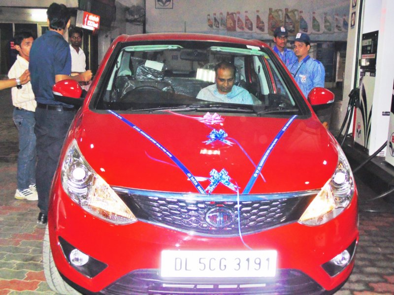

sharing some pics on day of delivery of my car. yestrerday just after bringing my new car i could not resist my desire to go for long drive with my new car. even after worse traffic situation on dhanteras in delhi, i enjoy a lot my driving. clutch is very light, driving hight adjustment give a commanding view of road, but never forget to adjust steering wheal too, otherwise you may not see driver's information display properly. its music system's sound quality is even better than my philips home theater.

Congrates!
