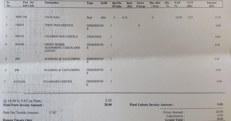

  • ECU software updated. Service Reps didn't know what changes the new version offered (bug fixes/enhancements etc) and neither did the invoice.

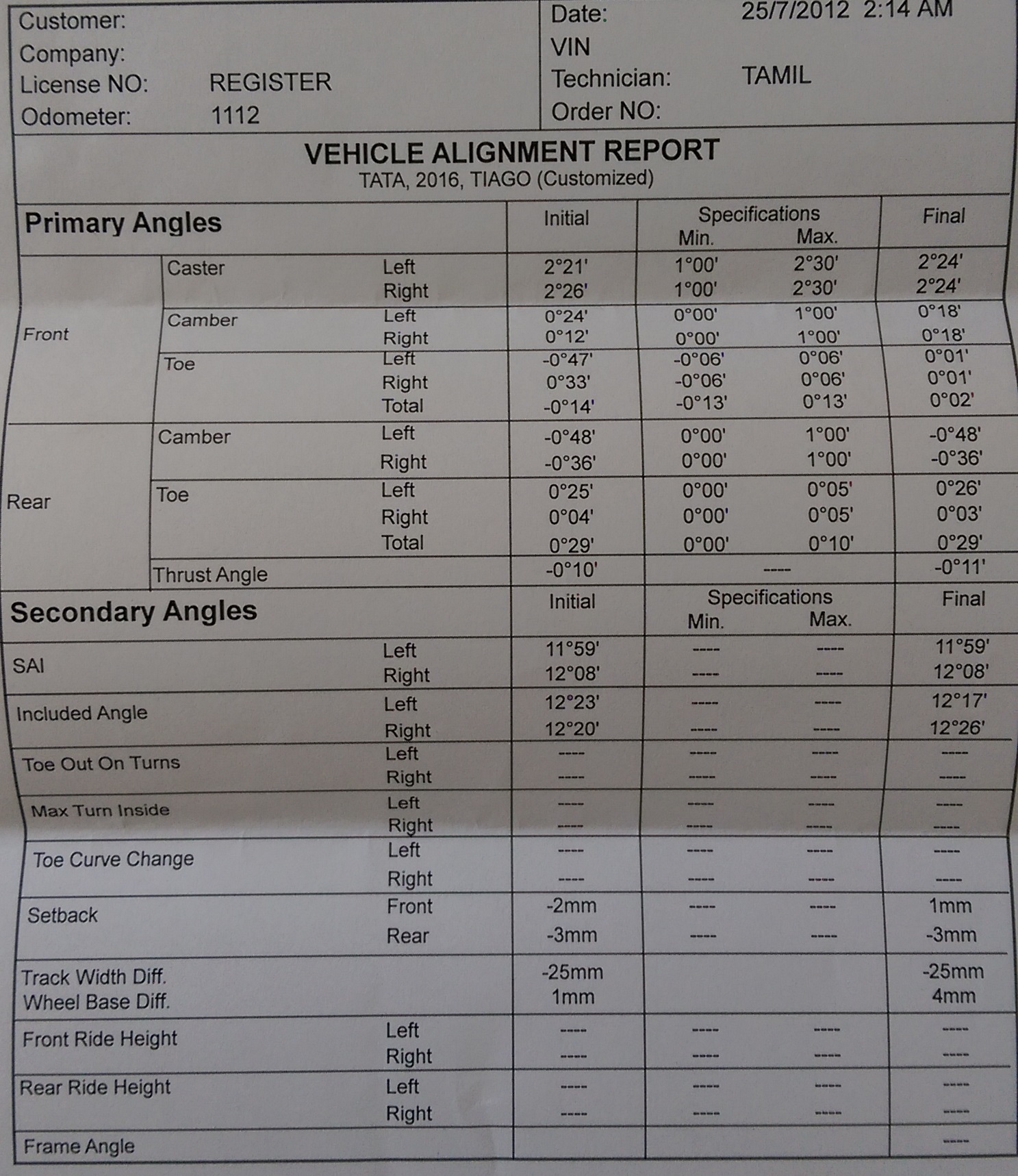

  • Front wheels aligned.

  • Minor dashboard vibration corrected by replacing a spare part named "Tack Rag". A quick Google search revealed it's a piece of cloth used for paint works [confused]. Anyways, vibration appears to be gone but facing sporadic minor rattling under the dash at around 1500 RPM. Will monitor closely after cleaning out loose items from glove box.
