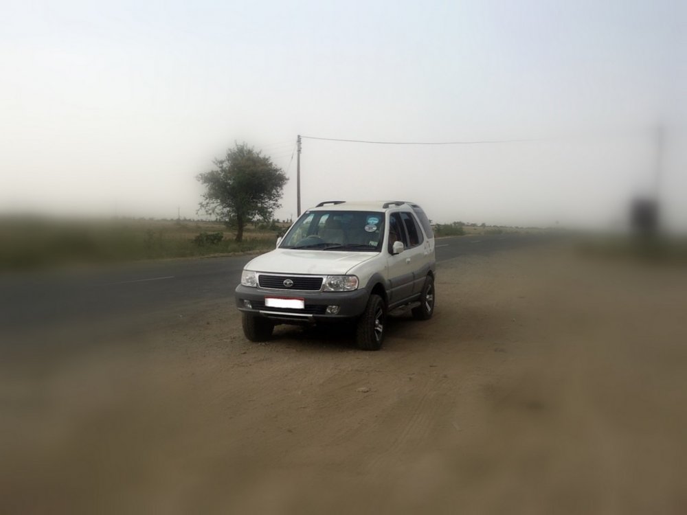

Below are few Pics:
Thanks.:)

[clap] very good review . did you steal my alloy :P hehe those alloy match safari very well . my suggestion get out lip of alloy black . any plan of painting bumper
Hehe.. Thanks. Those alloys came with the car, I have removed the alloys as of now and switched back to stock RIMS. These pictures are of sometime back. As the alloys made the CAMBER out. (which is now too) What LIP you are talking about here?
P.S: I like those Grey bumpers.:P Not planning to paint them.

-_-! you have removed alloy well your choice . now you don't have alloy no need to talk about alloy lip

Incase I switch back to alloys after camber adjustments, tell me what are those LIPS?

now about lips i mean this silver border line we call it lips [;)]
