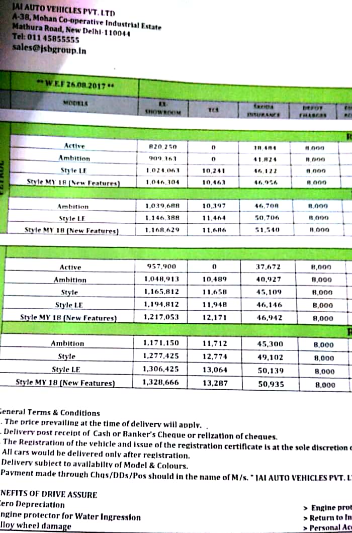

Skoda Rapid New Variant - Style MY18
Skoda have launched new variant which sit above Style LE variant and gets few additional features at just 22K increase in price. Additional features are :-
1. Updated RCD which now gets Android Auto, Apple Carplay and MirrorLink (same headunit is found in Rapid Monte Carlo)
2. 2 curtain airbags. So now top variant Rapid comes with 2 dual airbags (standard feature) and additional 2 airbags (for now limited to Style MY18)
© to Varun Mehrotra

Thank you for the information, but this info is not showing in the official Skoda website.
