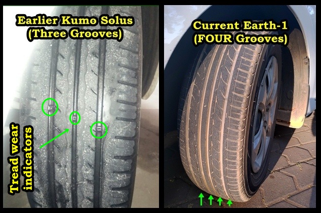

The intermediate Ribs (on either side of Tyre Shoulder) are showing even wear. That means “Wheel Alignment is holding Good”. Tie-bars (on shoulder) and Lateral Grooves (on intermediate Ribs) are still nice and deep. Condition of Tread Blocks and Rubber in general are good. Credit to myself and Yokos.
My earlier Kumho Solus had only THREE Circumferential Grooves, while Earth-1 has FOUR Main Grooves with identical width and depth. Michelin XM has only TWO, while Bridgestone B250 & GdYr Triple Max both have THREE Circ. Grooves Each. “Ceat Secura Drive, Conti CC, Yoko Earth-1 & Yoko BluearthALL have FOUR each. But, SURPRISE SURPRISE, in Earth-1, tyre Shoulders have ONE each NARROW grooves. There is a ‘sort of NARROW circumferential groove’ on each intermediate Rib (connected to main grooves via lateral grooves). Basically Earth-1 has overall EIGHT Circ. Grooves. I had always felt that Verna’s performance has improved while Cornering and on Wet Roads. Now I can safely credit THAT to Earth-1’s wider ‘outer intermediate Rib and the additional Circ. Groove(s)’ for that. Tyre noise also is down with Earth-1.

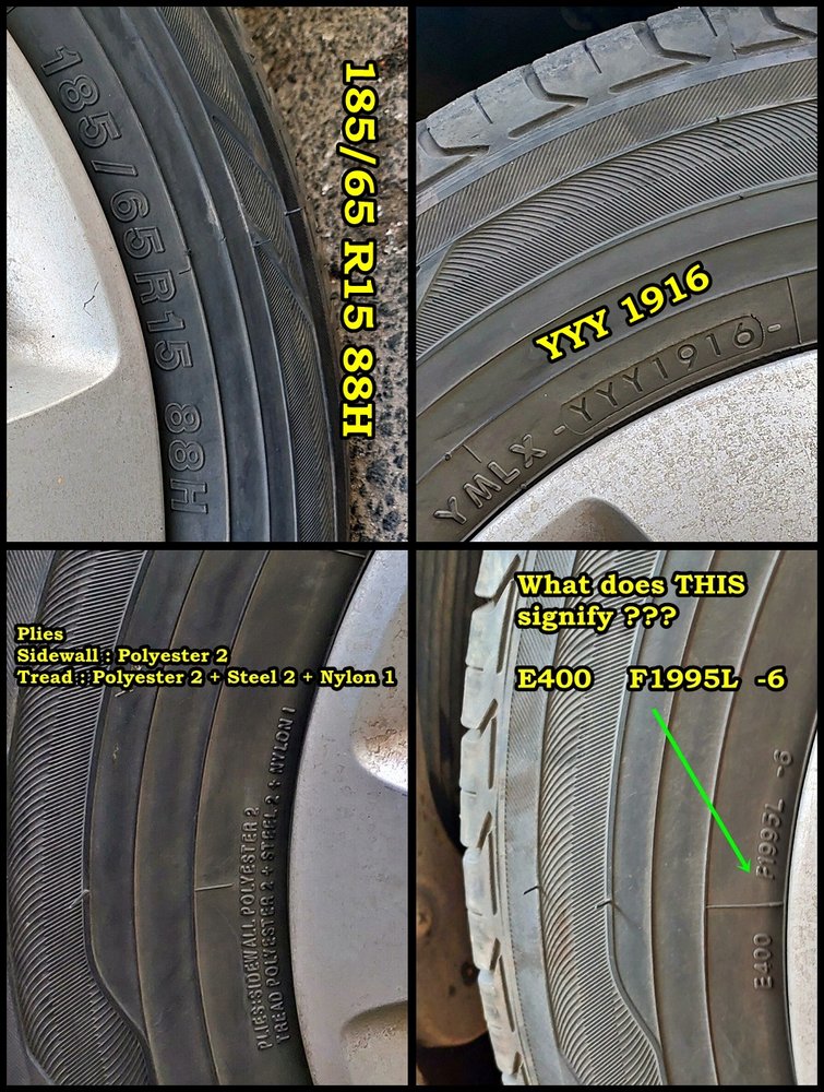

The various markings on the Earth-1 in a Combo Pic below:
BTW, what is the meaning of E400 F1995L -6 in the fourth Pic in Combo Pic above ? Any guesses ??
My Verna came with Hyundai fitted Kumho Solus 185/65 R15 88H. When the Odo was at 51,600 km 'Left Front' tyre burst and i quickly went for Yokos. I checked a old Pic i posted in TAI and found that the Treadwear indicators on the Solus were quite GOOD. All said and done, I think i panicked and bought the Yokos a bit early. Comparison of Solus and Earth-1 below:

...The various markings on the Earth-1 in a Combo Pic below:
BTW, what is the meaning of E400 F1995L -6 in the fourth Pic in Combo Pic above ? Any guesses ?? ... I will write more about a “major feat” of Tyres after that trip. Drive Safe and good luck to all. Adios Amigos.
  1. I found that E400 is another name for Yoko Earth-1 tyres. Yet to figure our meaning of "F1995 -6"

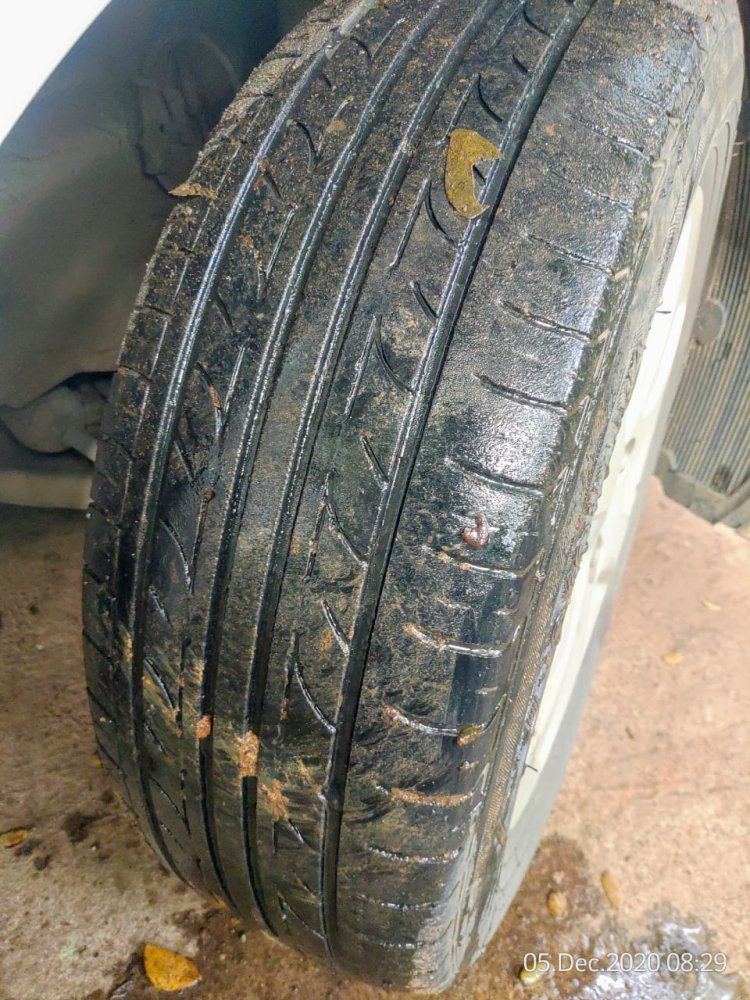

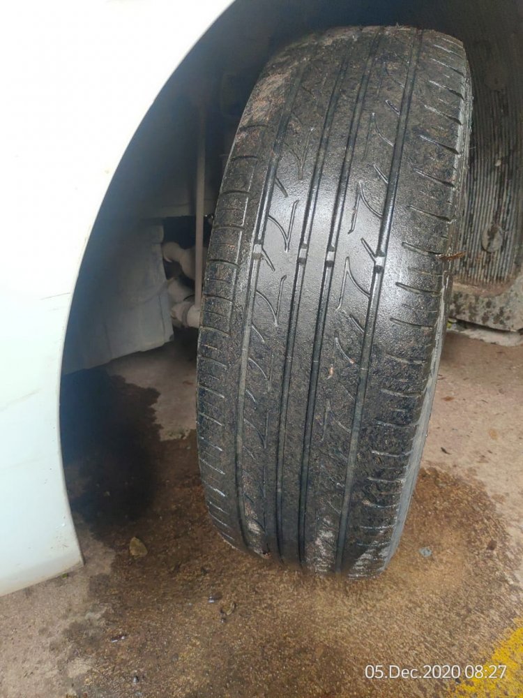

These Yokos came aboard in Aug 2016, with Odo around 51,500 km. Fifty one months later and with Odo above 97,000km, do they look like having done 45,000 km ?
Front Left (below) :
Front Right (below):
Pls pardon me for posting dirty pictures; it's in Co Car Parking & ran out of water.
I noticed the narrow grooves on the outer shoulders has disappeared while they are still there on the inside shoulder (is shoulder the correct term ?). Alignment problem for sure ; I'll reverse the tyres (inside out & outside in over the Rims) during next Wheel rotation.
