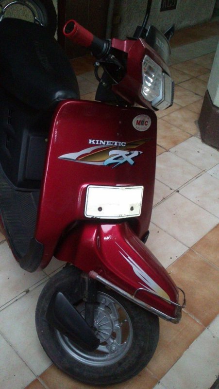

Wow !! The scooter looks good now.
Any reason to paint this color ?
I would suggest you replace the indicators / tail lamps with the last type (clean lens) which came with this scooter.

CANDY [glasses] will look very bling in the sunlight.

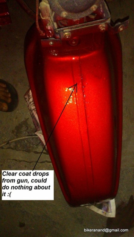

For the clear coat, is there any adjustment on the gun to control the spray?

Project completed and Scooter is delivered :D
Yeah you are right about the colour, almost everyone seems to give it a second glance since morning. To spray the Clear Coat, there are no major changes as such on the gun controls, except that the gun needs to be cleaned quite often.
The colour was chosen by the Painting guru and I just nodded my head. The owner thought that I was joking about the red colour, he always thought I would be painting it white. However he likes this colour also
The clear indicators are quite costly (compared to other parts) hence I skipped it, also wanted to keep the overall cost below 2.5K.
Thank you Sir.

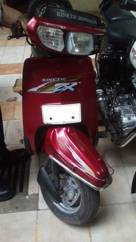

The Big Update:

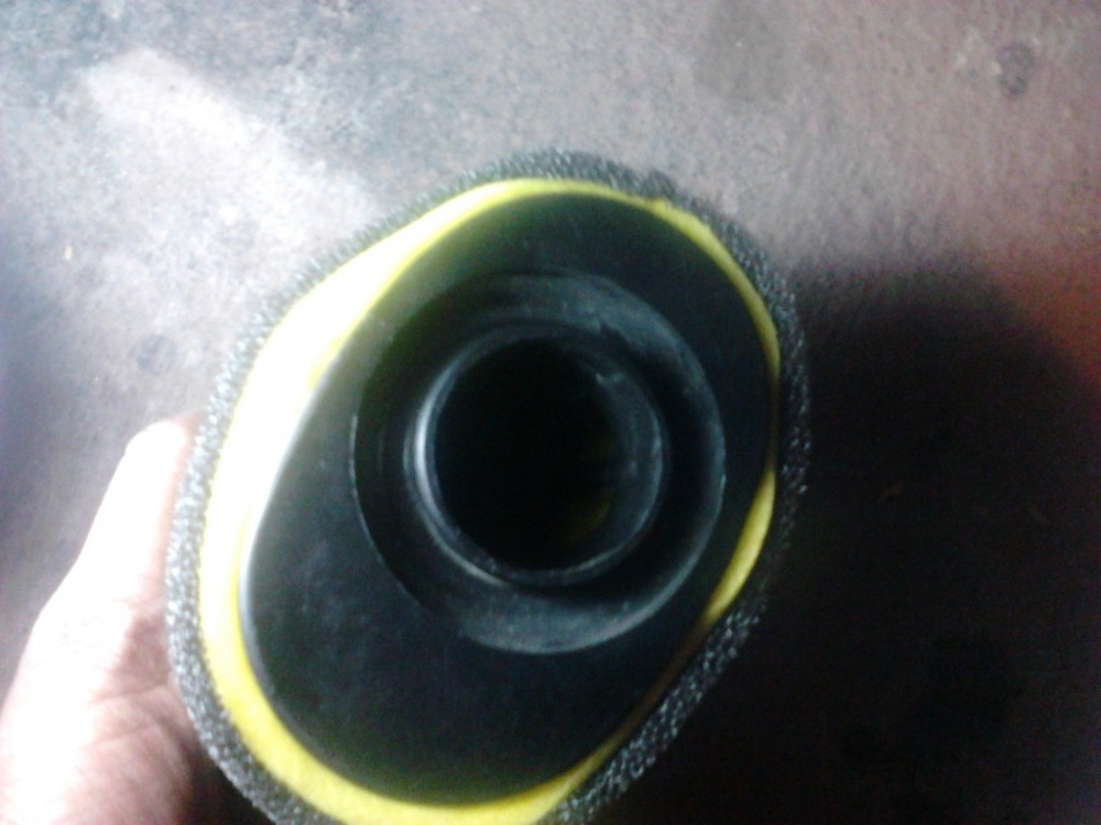

Today I went to J.C.Road, most shops were closed, still managed to get a partly broken Air Filter body (plastic part that holds the Air filter sponge on it), may be this is one of the last few pieces left in those shops. This one costed me 55rupees and about 45mins to walk to & fro to every shop that's open.
Also got a rear view mirror for left side and new front axle rod (old one was in terrible condition).
I met the owner at his office and took him to my home and he helped me out for a few hours to fix a few things and I showed him all the work done so far and a few tips on how to fix basic problems, what issues to expect in the next couple of months.

Then I did a few things to make him more comfortable with the vehicle
  1. Tuned the idling and tightened the throttle cable
  2. Fixed the airfilter body and the sponge in place
  3. Fixed the outer metal body protector as it was before
  4. Fixed back the stepney (I could not get a good piece for that grab rail type to replace it)
  5. Took it for a fast test drive on different roads and checked for brakes, rattles etc
  6. Gave a packet with screws (replacements for most of the them in the bike), just bought from J.C.Road, so incase he needs them for any reason in future.
  7. Showed him all the pictures of the restoration from day 1 till date.
  8. Showed him how to adjust the brakes, just in case he wants to adjust it later.
  9. Stuck all the body stickers, he fixed the 2 stickers on the mudguard (DIY)
  10. He took a test drive and came back with a very positive smile, delighted with the overall condition of the bike.
  11. Speedometer works as usual.
  12. Gave him 50ml of the original Metallic shade (added a bit of PU thinner, just in case he needs it)
  13. Cotton waste
  14. All documents and contents of the glove box in a cover
What is still pending: These things will be taken care by him within a week
  • Center stand spring is fine, but a small welding needs to be done.
  • One of the new plastic pieces in the front headlamp frame is not fixed, I dont have the correct screws.
  • Right side front indicator does not flash, just managed to get one working
  • Wet sanding and polishing (I will do it after a week or ten days)
  • Suggested him to change the RIM of back wheel
What has improved?
  1. Looks better than before
  2. Key controls are butter smooth - Throttle and Brake levers
  3. Self start should start working in a day or two (battery needs to be charged while running)
  4. Stopping distance is reduced, more predictable, more balanced while braking
  5. Major rattles form rear wheel and right side pull from front wheel is solved
  6. Idles well, starts in one kick start, horn works.
Usually my friend (WagonR guy) is the one who clicks the pics, today he dint come so not much pics to post. Tomorrow morning I will go to the owners house (before he leaves to work) and click a few pics of the bike (daytime ones).
So far the owner has spent about 2K easily everytime he services the bike (once in 2months) although the bike has not been serviced in last 6months, he felt it has never been this smooth till date.
In a 2 wheeler, some parts are cheap, yet they are the ones which decide the ride comfort. So changing these can simply add 5stars to the new looks. No point in giving a fresh coat of paint, if the bike doesn't start in a single kick. Isn't it?

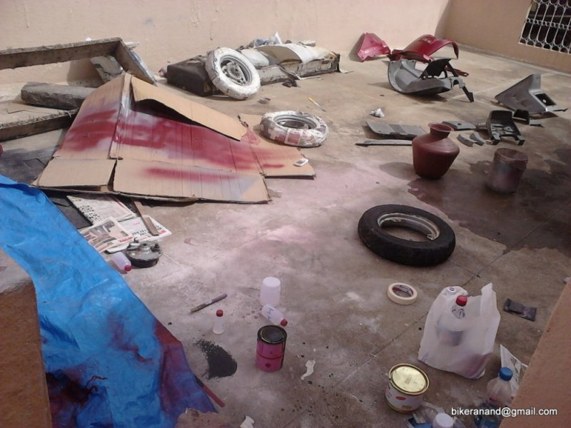

1. No major painting work till I have a covered space to paint

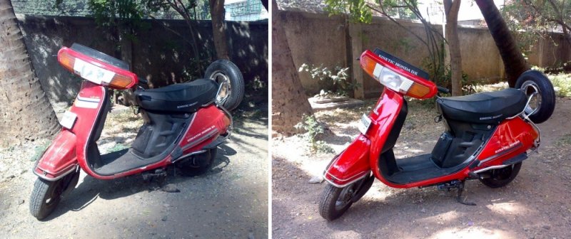

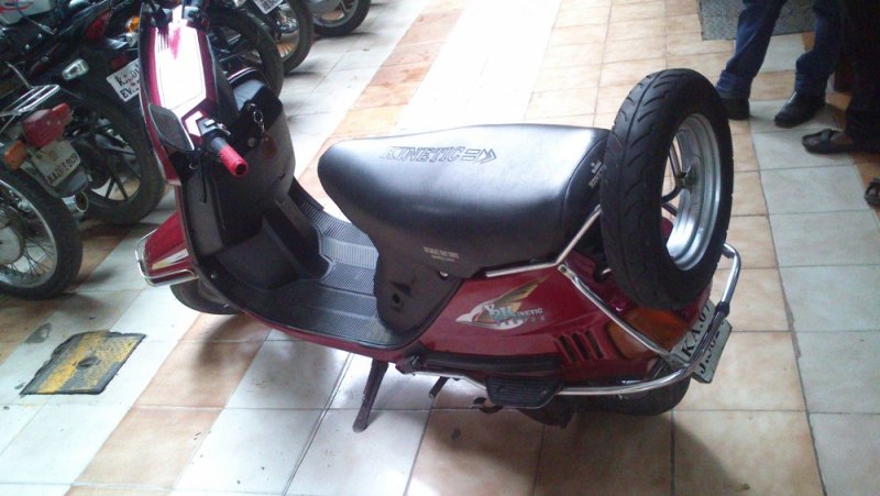

One more pic - the before vs after comparison.

I too could not believe initially, the difference between before and after clear coat is too much.
