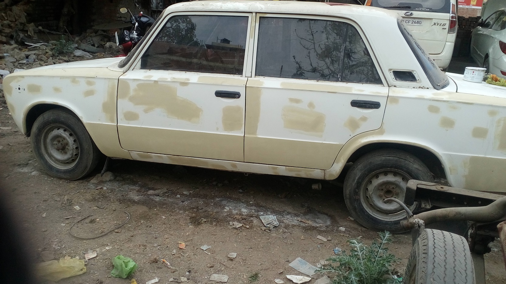

sorry for the late updates,i paid almost sixety percent of denting painting money to my mechanic,but he is too lazy to work on this car particularly.after carburetor work only this progress has been made now-
1)-Stripped down completely whole engine bay.
2)-All the metal components that were showing rust got treatment and painted them using black paint or may be black seal, also paint some small components myself .
3)-I found a fuel tank float unit ,didnt installed yet.there may be some difference between hitachi and mikuni setup so may have to block some return hose on float.
4)-Entire engine bay primered and got new paint ,i have decided to stick to white color after consulting with many friends,also registering new color in r.c. will be a problem so have decided not to change color.

Thanks dear,i am still new to this restoration process.But have tried my best to replace maximum things which i can manage.Because of my busy schedule,this restoration took time of almost one year,but now it is almost over ,max 15 days more to get all assembled.restoration cost excluding car's purchase price is reaching almost 80,000rupees now.
