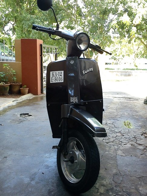

Vehicle Details:
Bajaj Sunny , Model 1995, 50CC 2 Stroke Engine, Auto gear.
Bought from : Olx.com Advertisement for Rs 4K (Documents intact with FC valid till 2017) , Location Mysore.
As the restoration “madness” was on my head after restoring my Yezdi, did not do any prior inspections before buying, Just wanted to experiment by completely dismantling & Restore only Mechanical work of it (Did not plan to Repaint, Chrome, etc. as it consumes lot of time & Money)
Restoration Plan & Spends:
Had decided not to spend too much on it, started looking out for spares in Mysore/B'lore, surprisingly got most of the spares of Bajaj sunny / Luna/Yezdi/M80/Lambretta in Amardeep Automobiles B'lore & Bajaj sunny related spares in Bajaj showroom mysore.
Work done:
1. New Bore kit - Paid Rs 1.2K (searched maximum for this in B'lore & got this in one Bajaj dealer in Malleshwaram)
2. Body kit ( Front fiber body & headlight top & bottom kit) Rs 600, initially planned to DIY painting & replace the existing ones, later decided to retain the originals & keep this as spares ( See pictures for details)
3. New stand , Cable set (Brake,Speedo) Mats ,Brake pads ,clutch pad ,Cone set ,Speedo worm - Total Rs 2k
4. Engine bearing/oilseal/shaft work , Mechanic payment Rs 2K

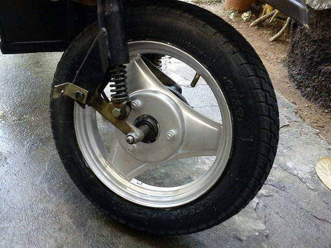

Decided not to paint & DIY Polish at home ( Both Plastic & Paint surface),
DIY
1. Cleaning the Rims & Spray paint (Can paint) Cost Rs 600 - 1 can of silver paint, One Flat Black & One Clear coat - Has come out excellent
2. Fiber Polish -Waxpal (used for leather & plastic), wet sand with 600/1500 grit & apply multiple layer of polish 3M & Amway polish - new like finish
3. Speedo meter restoration - Lots of mechanics in mysore to do this, paid rs 150
4. Completely dismantled the vehicle myself & got the pressure serviced it for cleaning the dirt, (mechanic helped to reassemble it though)
Total no of days it took ( 3 dedicated days), 2 weeks to search for spares . Vehicle runs very smooth & definite Head turner when you drive in city.

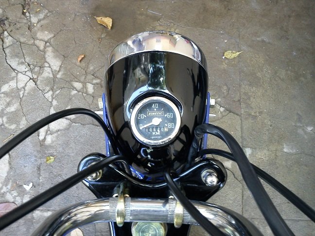

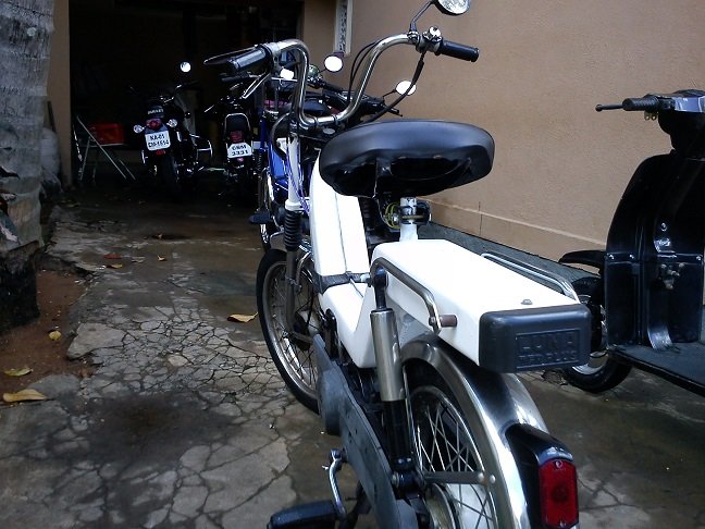

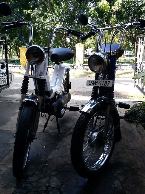

Also posting few Luna pictures .
Blue Luna -
Bought for Rs 3.5 K Single owner.
Complete restoration done, dismantled completely, repainted, re chromed, engine kit , rubber parts etc are completely done. Spent a lot on this.

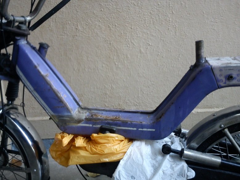

White one -
Bought for Rs 900 just to use it for its spares from a road side mechanic. Later found the owner & got the papers for another Rs 750.
DIY painting – Can paint, mechanicals from local mechanic.
Both are in excellent running condition.
Sharing the pictures.
