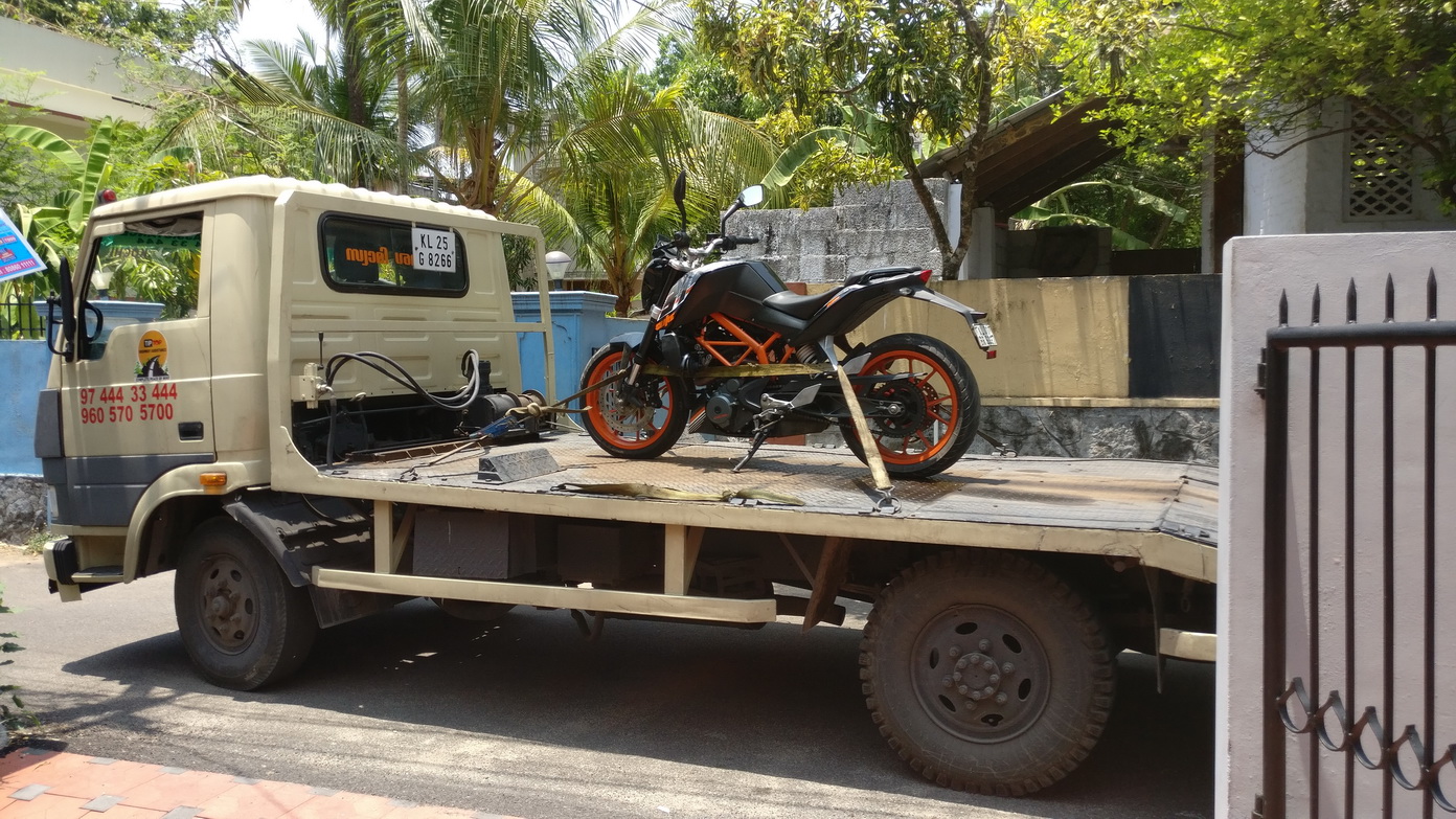

Orange Assist to rescue. Was expecting a small Tata Ace or Piaggio Ape, but was dumbstruck seeing this, a flatbed [lol] Took 2 hours to come after making the call, but the response was overwhelming.

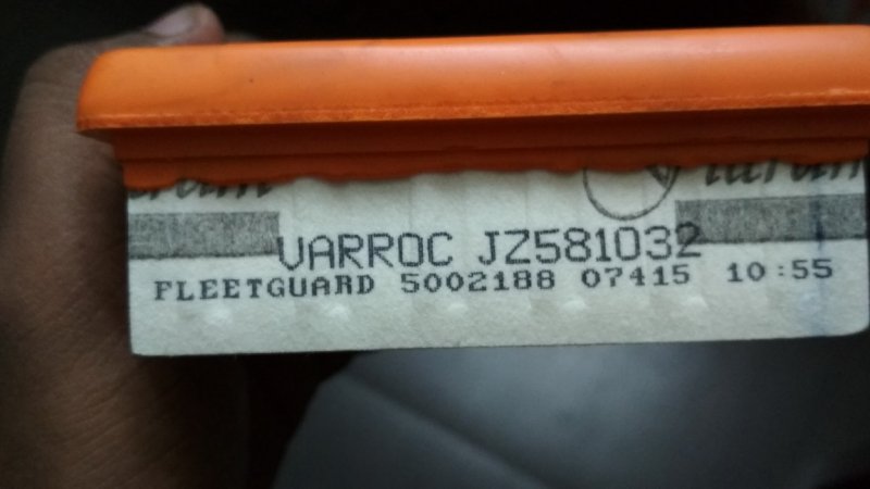

He even changed air filter. This one is from Discover and he says is better than KTM OEM. Discover filter is 40 rs costlier than KTM filter [lol]

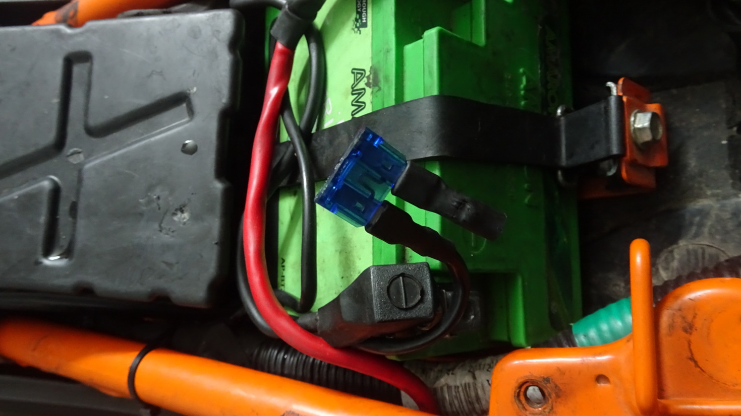

Gets custom LED. 4.5W (0.5W x9)
