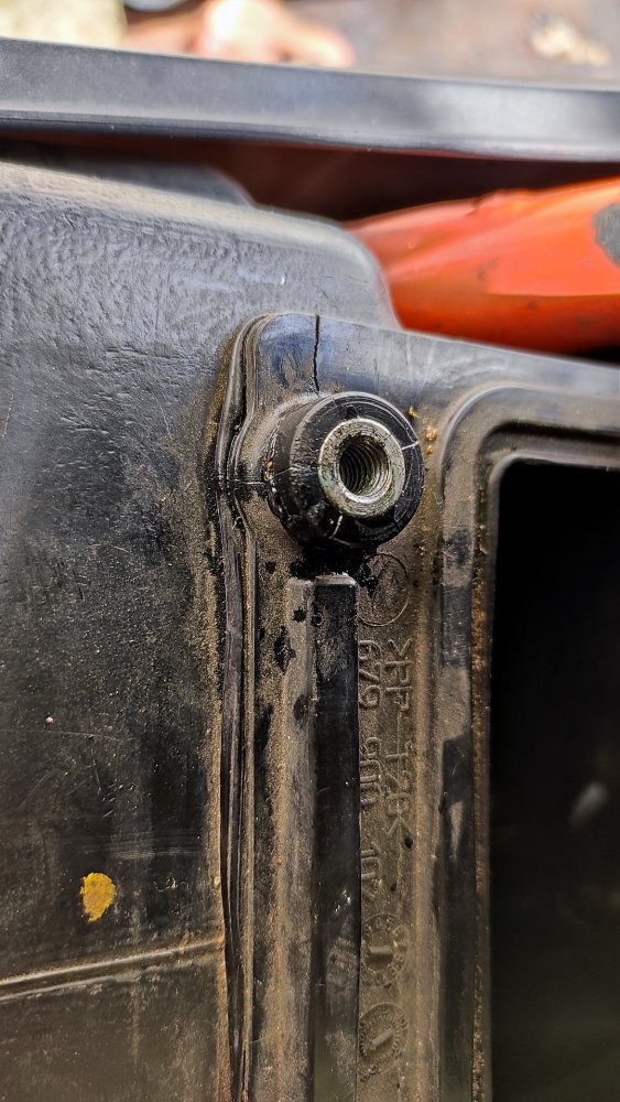

December 2021 - Oil Change
Air filter box nut/mounts broken.
View attachment 301510 View attachment 301511
Fixed with superglue.
Ah, well have the same issue, but my airbox doesn't have that steel mount to where the screw sits, so the screw just grinds the plastic. Recently while checking the airbox I found a piece of the plastic at the bottom of the airfilter box. I'm pretty sure it fell inside either while tightening or removing the screw, as the holes are badly stripped and I can actually peel of the loose strands of plastic from the screw.
Will the filter actually prevent these strands that fall to the bottom during the tightening and removal process from going into the intake? From the looks of it the filter does cover the intake.
Yeah, filter would take care of that.

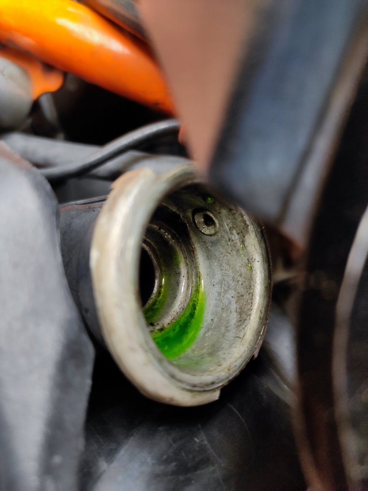

The issue starts one by one. The coolant was spilling from the coolant cap when the fan kicks in and then through the expansion tank overflow when the engine was shut down. Called them immediately and picked up after a couple of calls and asked us to bring the bike all the way back. Evident that the bike wasn't even tested (or even started) after work. This is when we found the expensive coolant.

Cycled a few times and the issue persisted.
The culprit seemed to be the radiator cap. Bought one from Prime Motors, a nearby Bajaj spare and service. Common part for most Bajaj and KTM bikes. The issue was sorted out.
Radiator Pressure Cap - JG601235 - ₹ 153.00
The old one seemed aged. They could've checked this while filling the coolant, at least. Suspicion for a swap is behind the head as the bike has been sitting there for quite a long time.
