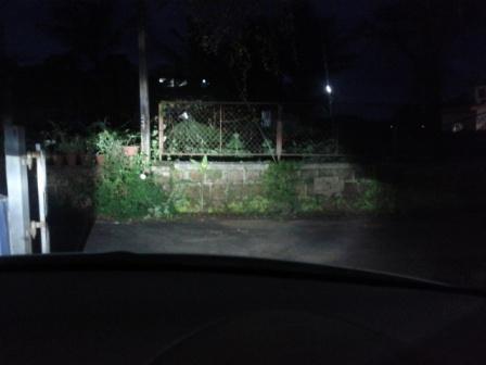

Finally installed the HID projectors.
Looking great bro , congrats! Do you feel any improvement in visibility? Got any chance to test it in rains , heard people saying during rains HID'S are not effective.
