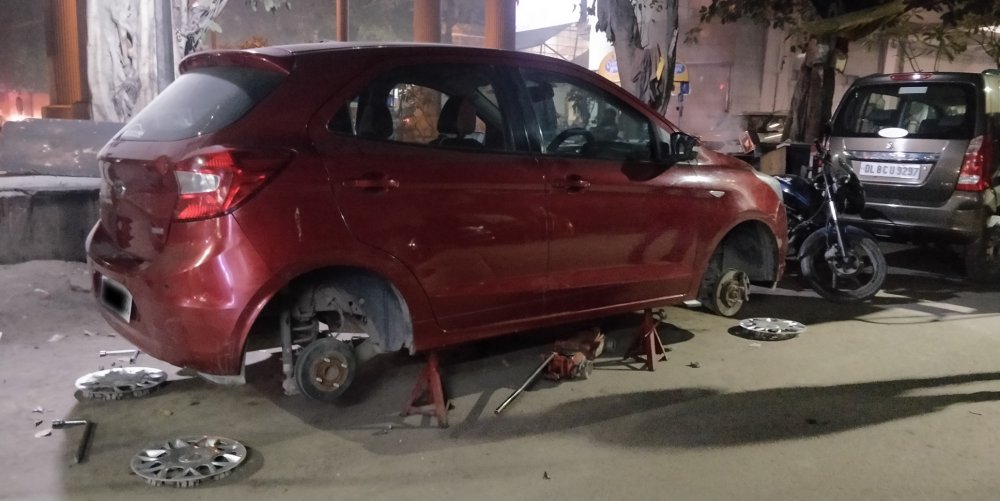

Got the tyres changed to Yokohama earth 1 @ 4100rs per tyre. Standard size replacement.
So the advisor was lying that he has done caliper pin greasing plus brake cleaning for which he has charged me in the bill. Talked with him and he accepted his mistake. Now let's see how long does he take to return back my money through proper channels. Earlier he was saying I will send the money via Paytm to which I said why should I take your money. Get me the money from Ford.
Not going to take my car anymore to harpreet Ford.
also got a call from Ford representative about the complaint I made about the 15 days they took to repair the car.
after confirming the details with me she didn't say anything to me what steps will be taken care off , future discounts or getting details from the advisor. Instead she asked me " what do you want " [surprise]
Hell , give me a mustang (obviously didn't say this) [lol] I just hung up the phone. I was really surprised why and what the hell I will tell you what you can do. Really lame representative.
