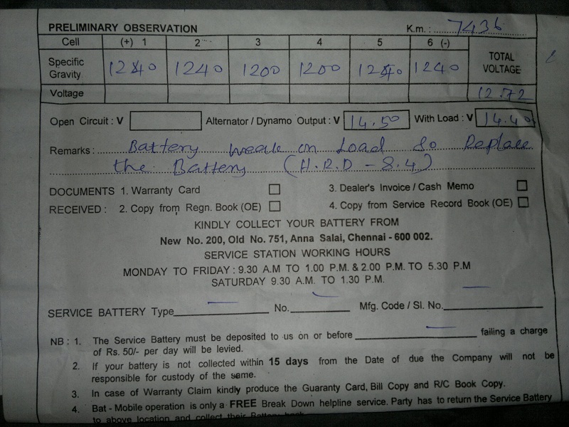

My dzire vdi started showing SVS and WATER IN FUEL FILTER warning signs in the instrument panel since yesterday. About a week back when my car was valet parked the driver informed me that the vehicle was not able to start and they initiated a push start. But I didn’t believe as it was functioning properly till that time. I didn’t have any issues for 2.5 yrs since my purchase. So i didn’t suspect my vehicle.
Yesterday after 3 attempt start, the vehicle displayed these warning signs. However i drove it for around 6KM and no issues except the warning signs. After a couple of hours when i started the vehicle those warning signs have gone. Even today these signs didnt show up.
So called the exide bat mobile guys and on inspection they told that the HRD rate is 8.6 which should not be below 9.
I have attached the report given by them. They say that I should get the battery replaced as the battery started giving up.. He told that some dyanamic xxx( sorry cant remember) has some issues.
He told that if the engine is started, the voltage of the battery output goes down to a max low range of 9.6v and reaches a max of 14.6v. While driving, using ACs or headlights can cause fluctuations in the battery output which is normal. I have absolutely no idea about all these buddies… So please suggest me if its mandatory to replace the battery..
If so , I heard exide batteries have lost their quality and several users suggest to go for AMRON instead.
Awaiting your valuable advice..
Thanx in advance….

Hey buddy welcome to TAI!!!
Well its not that Exide batteries have lost their quality. OE batteries are generally not that good as the other costly dry batteries are. Companies always go for these kind of cost cutting techniques. Another example is giving slim 165/80/14 tyres on a car like Swift and DZire; where I think minimum tyre size should be of atleast 185section[:D]
