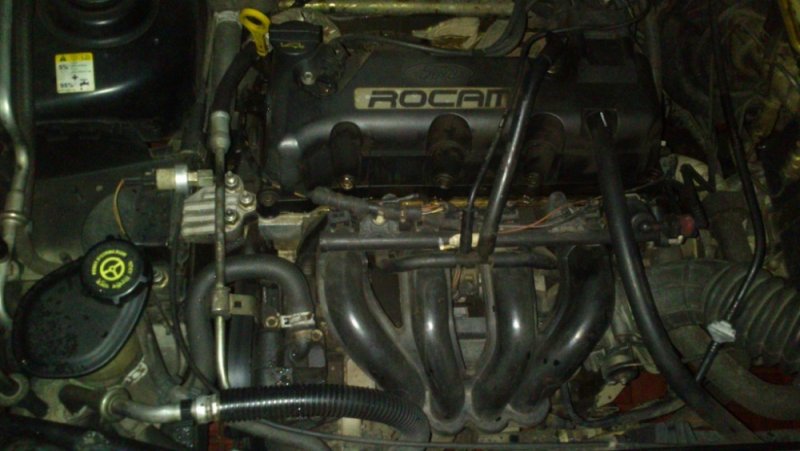

Saw one more Ikon today!
Also today saw one more car, it is a single owner car below are the details
Ford Ikon 1.6 Nxt Petrol (top end) with OEM alloys

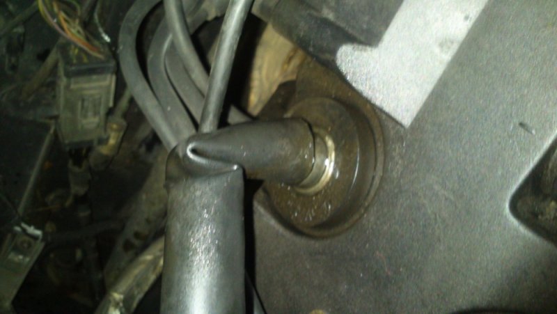

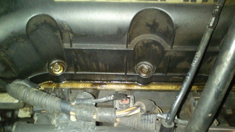

3. Oil leak from the tappet cover (see below pics) & the age of bolts on the tappet cover are different, hinting that the cover was opened & may be the damage inside is too big to repair hence they just put it back without fixing it.
4. Oil leak is so much that it has fallen on the RH drive shaft as well (so drive shaft boots will be giving up pretty soon)

Also would like to know, approx cost of such repairs on a Ikon (the oil leak part). Any info will be highly helpful.
