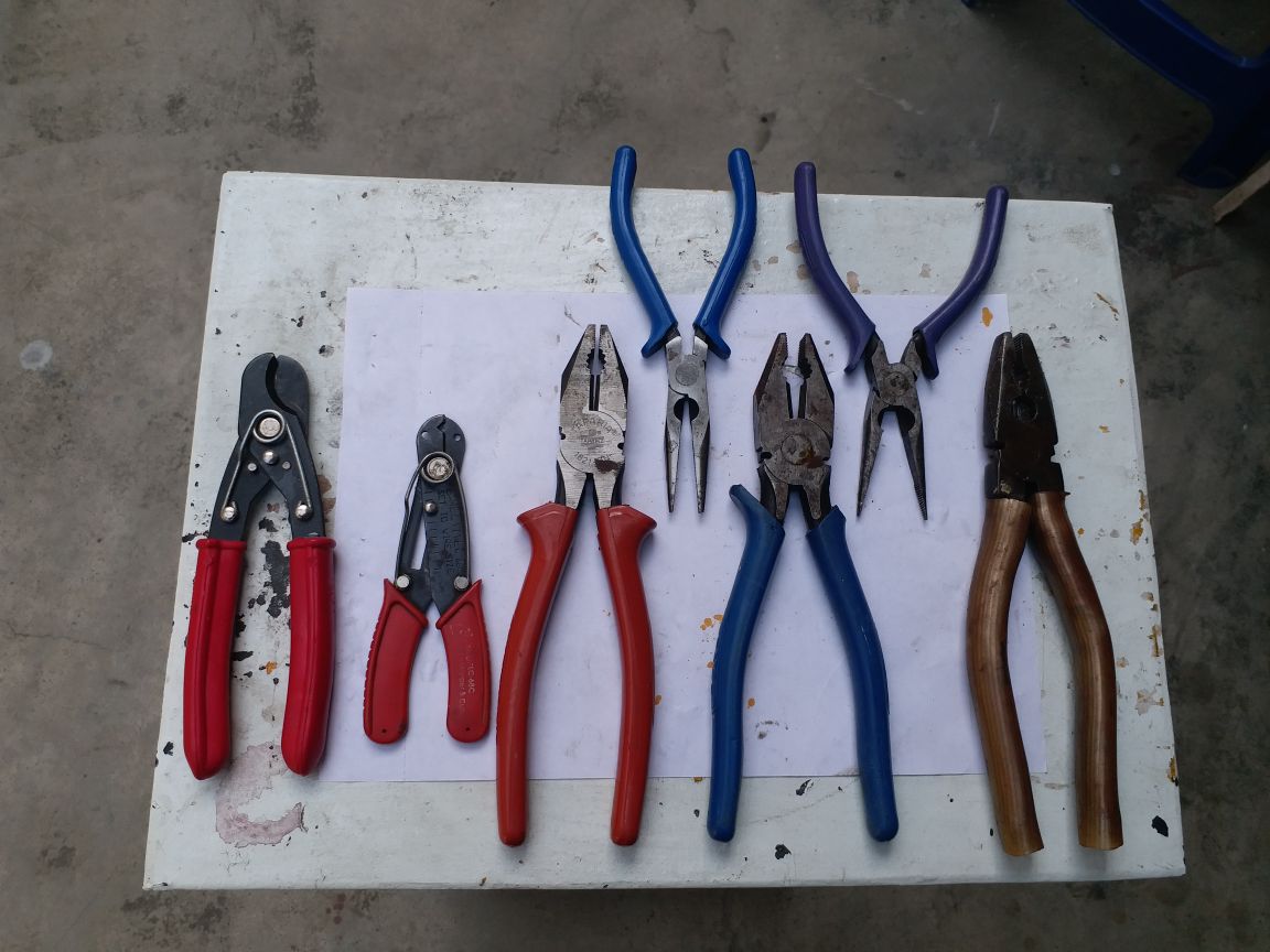

Various pliers .Red one is Taparia brand.

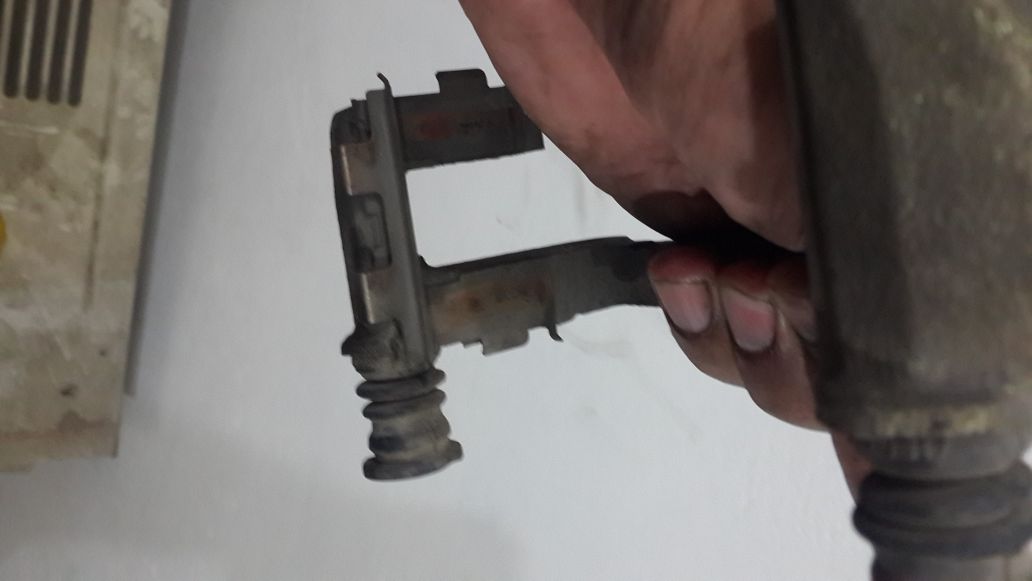

DIY Changing the Brake Pad on my SWIFT Vxi at my home.
My swift front brake pads were not fully worn out,but were making lots of screeching sounds.There was lot of brake fading too.Surprising thing was that even after 44,000 kms swift was on original brake pads,and OEM pads were not even worn out to HALF its thickness(as can be seen in the pictures).They had just gone very hard over the years,and were giving brake fade issue as well as unpredictable braking+ screeching sounds.I ordered the part no from my catalogue and procured the same from the dealer the required parts and went about changing them in my home.I had a lazy sunday evening dedicated to it.I disassembles both sides brake assembly and fished out the brake pads.Final result was very satisfactory.Now no more screeching and fading issues.Its performing like new!!
ADVICE:Brake pads should always be changed in pairs ie both the sides at the same time.
As can be seen ,the old brake pad has not even worn out to half the original thickness.

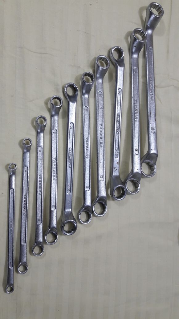

Screwdrivers,more screwdrivers and wrenches and some more spanners of all sizes.As can be seen the largest screwdriver I have is 22 inches long.

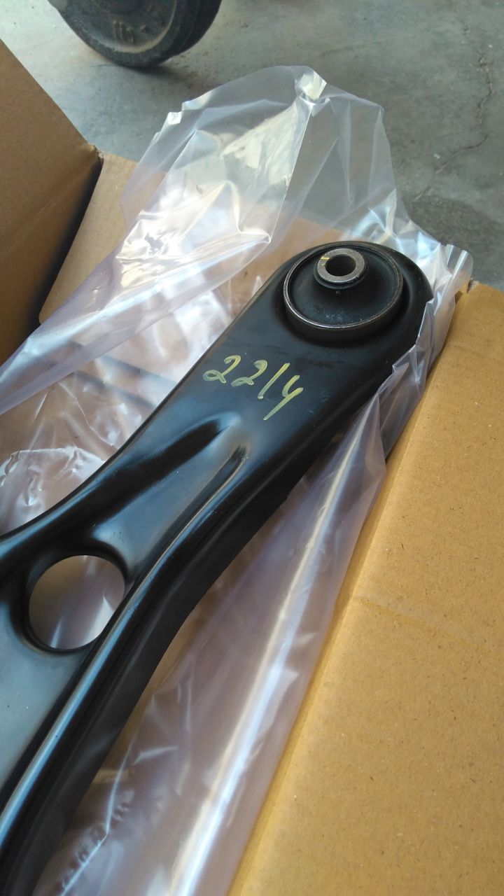

DIY Changing the suspension arms of swift petrol at home
There was weird khatar-khatar sound coming from both sides of suspension in my swift. After repeatedly driving and braking (over rough roads),the sound was diagnosed by me,to be coming from worn out front suspension arm bushes.I raised my car on the jack-stands and on close inspection found torn rubber and disintegrated bushes resulting in the sound.I procured 2 brand new suspension arms from the dealer and went about changing them.End result-Its totally soundless no-matter at what speed and at what rough road you drive.It took me 2 hrs total and the labour was free [:)]
Now the pictures..
