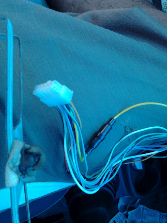

My HU(Mitsun MIT222) was not working,Removed it and opened it and found that the USB port is broken,searching for USB port matching it.:)
Some Clicks.:)
Wiring:
What is that black thing?

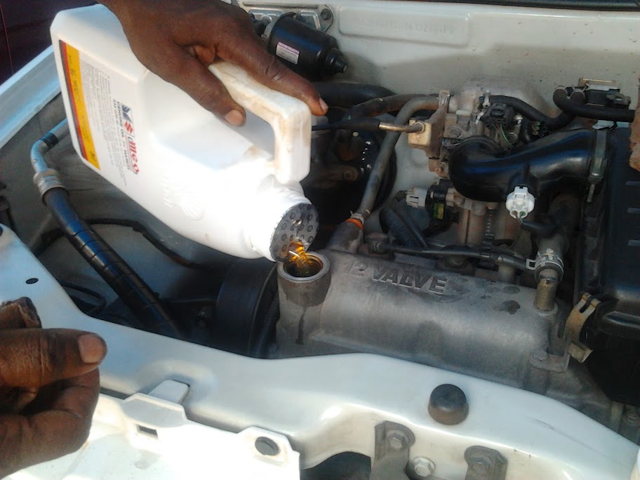

Changed oil & More
Changed oil today,Have a look at the pics:
When drained the old oil.[frustration]
I have to pour in full 3L of oil.(I mean i poured in full bottle of oil i bought,it was 3L bottle) still its a bit less than the max level in the gauge.Is it OK?
Manual says it needs about 2.7ltrs only,but i have to pour in full.[confused]

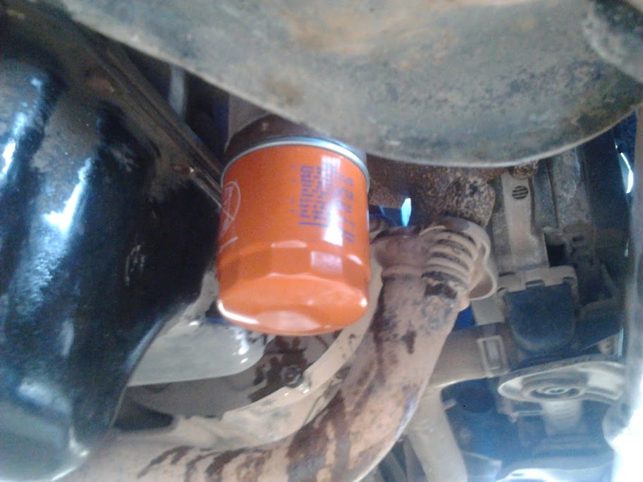

Fixed new OilFilter,I removed old one and fixed new one with hand and made sure that there is no oil leaks.Where can i buy the oilfilter removing tool?
Poured in new oil. MG Oil 20W40

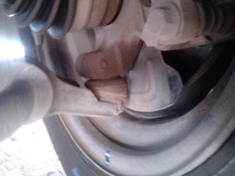

Also check that bush of arm,Is that bush OK?
Pic of old filter attached.

HU not working,modded the USB port,but still its dead!!![frustration]

im not sure about capacities in the alto but is it written 2.7l with filter or without it? if its below max level top it up just ensure its not less then then between max and minimum.
and boy the old oil was dirty how long has it been in there?
i did an oil change of my car today. way earlier then the prescribed interval and it was as black as your oil even though the oil has been filled at factory.
cheers i see an alto in pretty good and caring hands
I guess its without Filter.
Its one or 2 cm below the max mark.Seems like its OK.
Dont Know,I think its older than 10000kms.[frustration]
I am planning to replace every 5000kms.Now its 45903kms,will do next oil change at 50000kms.[:)]
I love DIY & Special thanks to people like you, for sharing knowledge with people like me.[cheers]
Any idea about the Oil Filter removal tool and coolant fill?

for the oil filter you could use any one of these two.
http://www.ntxtools.com/Merchant/graphics/00000001/otc-6905.gif which i will eventually use for my car since the position of the filter is vertically fitted near the oil sump.
and
http://www.classic-car-magazine.co.uk/articles/images/oil_change/oil_filter_wrench.jpg this would be helpful otherwise can be used for me also but would take some effort.
regarding the coolant i read somewhere it is 2.5l I'm not sure about the amount of water and coolant but my service guys for my other cars add 50% coolant and 50% water. A good parts shop can help you if its not given in the owners manual and also which type of coolant to use as new cars with aluminum radiators need specific coolant meant for them
Where can i buy these?
Will get this done from a good mechanic and will let you know guys.
