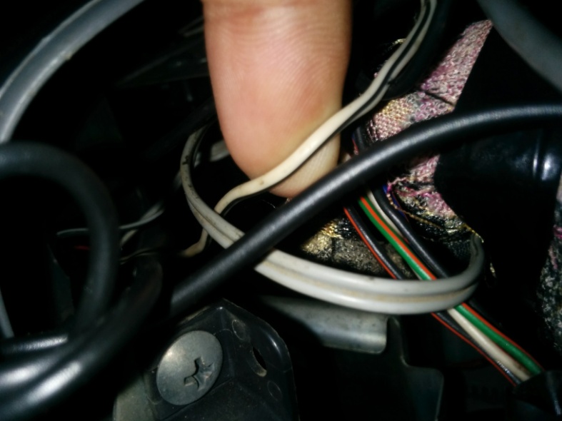

Other members have confirmed that positive wire for power socket is already present in every car. So you just remove the ash tray then by removing two screws remove the trim and install the sicket.
There is an OBD port below the ash tray find it. There is a bunch of wires running to the OBD port and in those wires there is a gray wire with a black stripe which is not connected to OBD. It is the wire for power socket. I am attaching the pictures. For -ve you can take a wire and connect it to direct car body with the help of a screw above the clutch paddle area.[:)]
Oct 15, 2013
54
5
london
Thanks saroya brother. great help. i will check again for OBD port. i couldnt find it yesterday...
is it okay to tape wires together and? and can you tell me a nearest place that i can hook - wire to a metal body. thanks in advance
Oct 15, 2013
54
5
london
i checked near OBD port wires i couldnt find a grey wire. but when i check all OBD wires there were 2 seperate wires and they wire taped to with OBD wires.
One wire is yellow black strip one. other wire is full black. they had green rubber connectors at the end.and theywere connected to nowhere but taped with OBD wires together. are those for 12v plug?
Thread Starter #225
Jul 29, 2013
811
776
Hoshiarpur, punjab
yes it is it[clap], just check them before you proceed. take any 12v bulb and by connecting those wires check if it is lighting. i am sure it will. That yellow with black stipe should be +ve and black will be -ve. +ve will be connected to middle of the socket .[clap]
