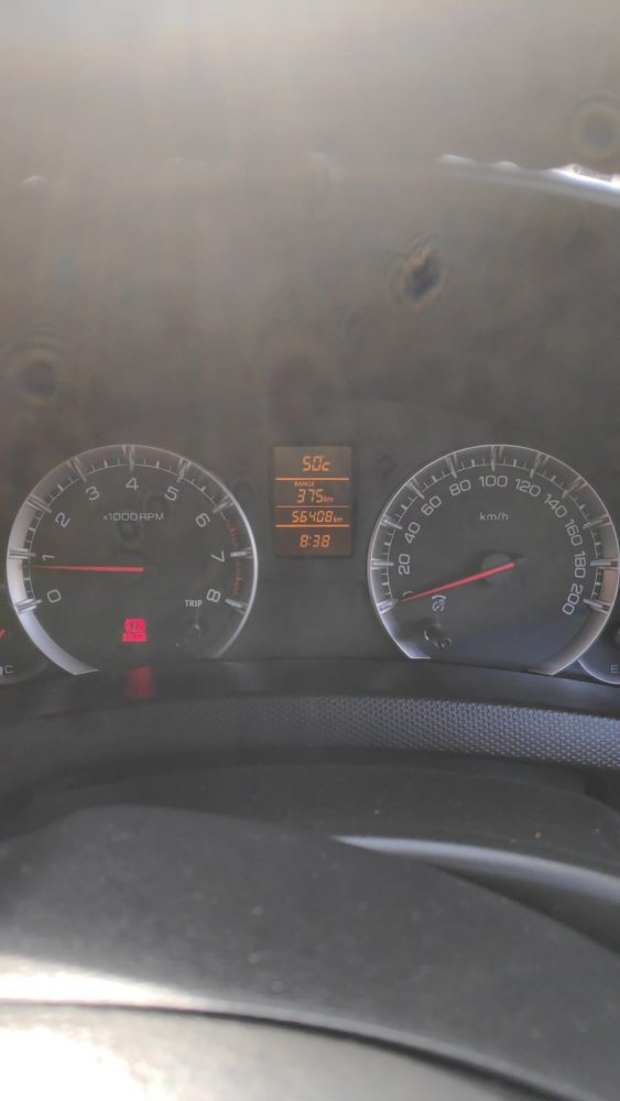

1. Temperature showing 50.

The MID temperature displays 50 degrees...I had did an OBD scan, it is not showing anything, what maybe the issue ?
Also does this require urgent action, as will it influence working of any other components.
External temp sensor is at your bumper grill, clean properly. Remove the soket clean it properly. Sensor is just a simple thermocouple changes restance with the temp. Restance is caliberated to corresponding temp.
