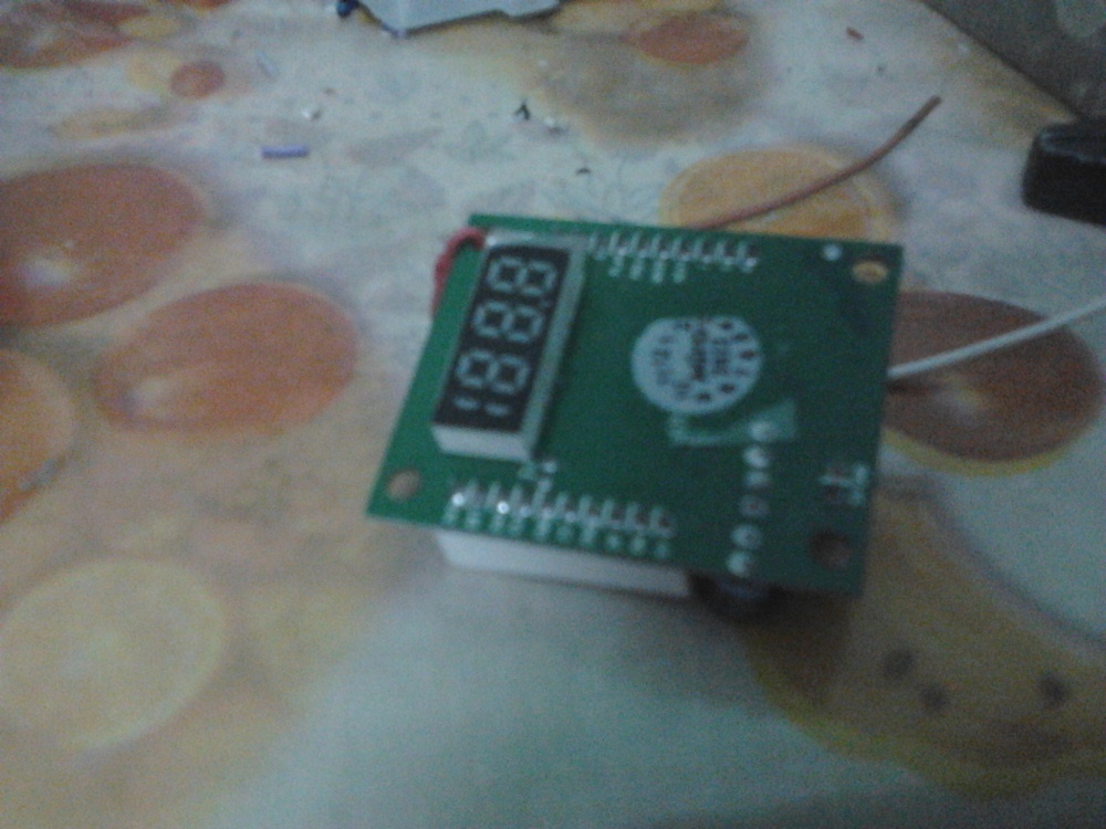

The cassette player I installed was giving some troubles, so decided to make my own amplifier.
Took out all the components (Circuit and chasis) and installed a self made audio amplifier circuit.
Installed a 35v 1100uf capacitor
attached a USB player circuit
12v to 5v converter using IC LM7805
Its an amplifier with 4440 double IC with sound output of 200W PMPO. Tested it with 2 Harman 50w 10" woofers, 2 Sony 150w speakers and 2 tweeters.
Sounds nice.
Will install it in the car soon
Sounds nice.
Nice,what is the total cost of amplifier?Please post pictures after fitted on your car.

The total cost of the amplifier is Rs 600. It can be made within Rs 400-500 if local parts are used. I used SANYO ICs and components from Phillips and Elcon, thus it was a little expensive.
Will post the pics soon
