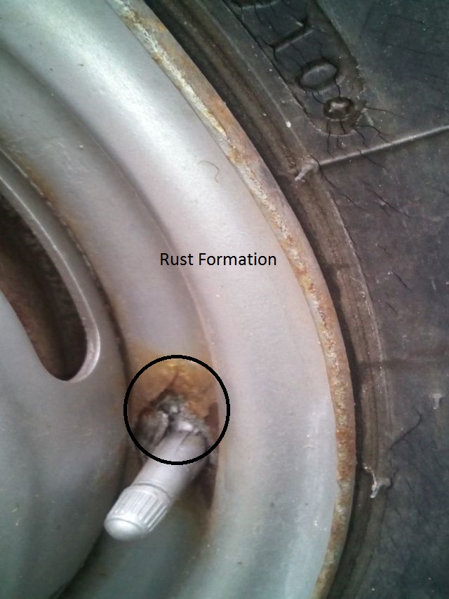

The Right front rim was rusting near the valve.Luckily,the MASS have given a nice touchup(More photos tomorrow)
Dec 15, 2011
341
279
RANCHI/BOKARO
Shrijit, can you see the part number of "steering assembly", which costs 4900. I want to know what did they replace. May be it's d column assy. For the rims, if they are rusting again, get new ones. You will be tension free for another 15 yrs
