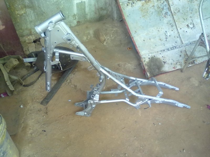

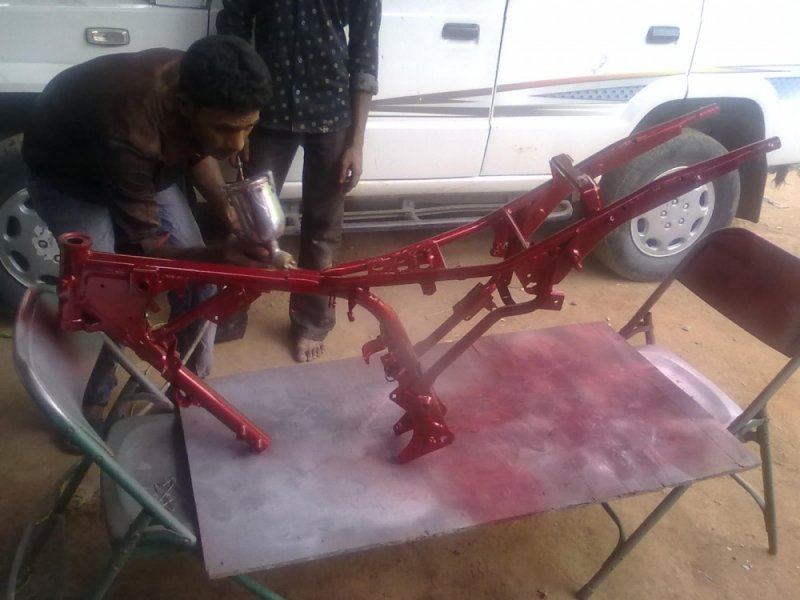

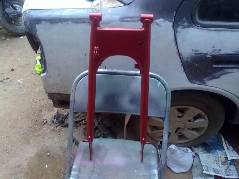

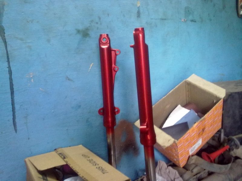

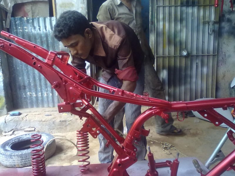

Paint job is being done excellent... I liked it...
 First scraping
 Second Red Oxide
 Third Pasting
 Fourth Scraping again
 Fifth Silver Paint
 Sixth Scraping for smoothing
 Finally Color on it
And then coating... planning for the graphics in flames...

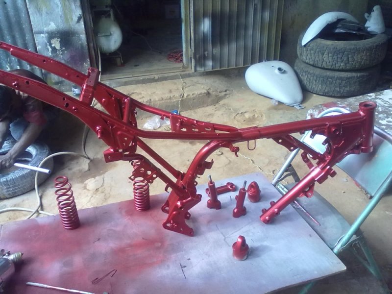

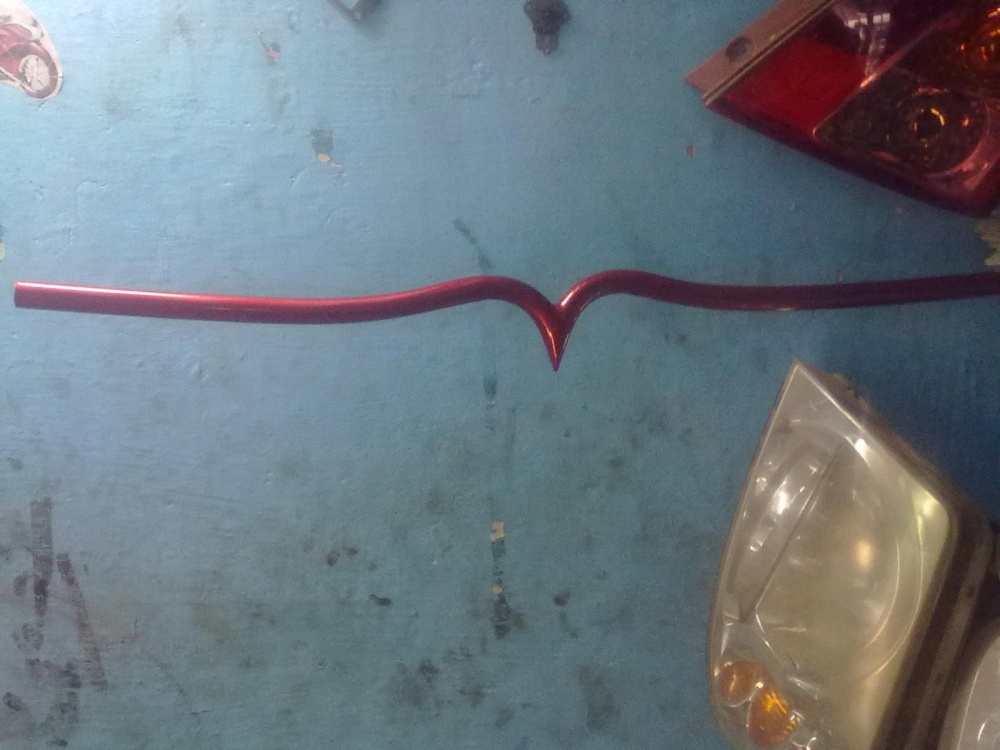

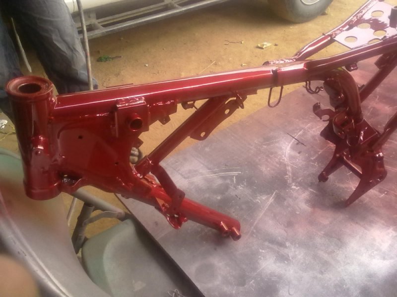

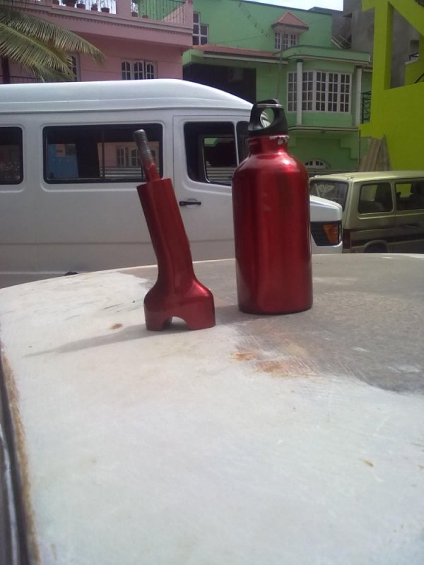

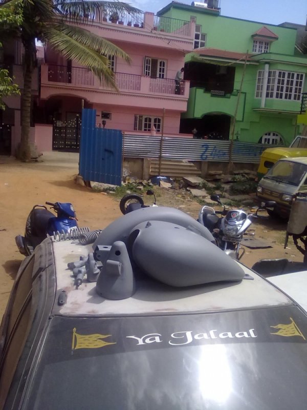

Few more latest pics updated as of today...
Painted and Thinner finish...
Tank, Mudguard front and Back, Headlamp will have some graphics job done...

Damn why didn't he use oven to bake the paint?
that can lead to the dust issues and paint not sticking properly
man your spending money should've looked out for that
