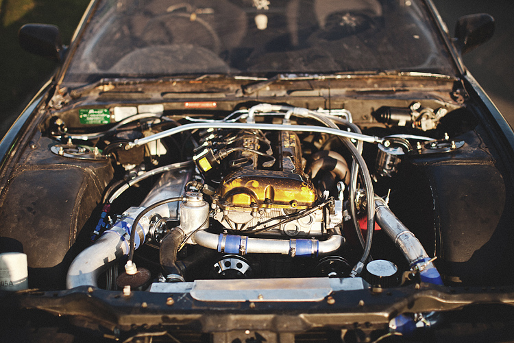

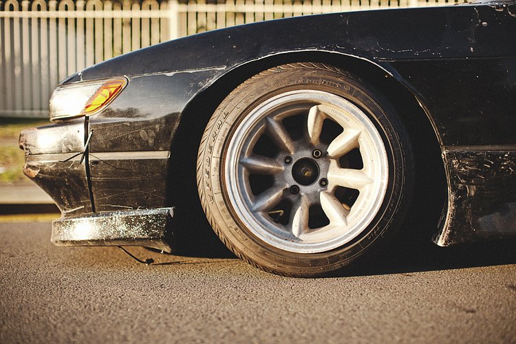

This being my second post, I don't want to sound too cocky. neil hit the nail on the head, he was right from his first post.
You just can't drift a FWD car. Its called a powerslide if done with a FWD.
I'm no professional drifter, but I've driven my mates drift-spec Nissan Silvia S13 with a SR20DET engine.
And I call it "drift-spec" because it had had so many modifications to help achieve longer holds and higher angle of drift. Drifting usually is loss of traction in the rear wheels (not locking them up).
With my mates car, here are a few mods from the top of my head:
Suspension: Fully adjustable BC coilovers. The are set in the hardest possible setting and lower than you can even imagine. To help him go lower, he has custom built the wheel arch tubs and strut towers.
Rear camber is at -3deg, this is an answer to the question posted before. Yes, tow out, negative camber all "help" with drifts, basically its having the least amount of rubber sticking to the ground.
A picture to help understand camber.
and here are pics of my mates S13 that I speak of.

Thats ripped of S13 mate
Lot of mods on S13.
Silvias from 180SX to 240sx were the perfect drift cars. Why is the car sitting on slick tyres.
how come it doesn't have bonnet and registration? and where is it now?
Lot of mods on S13.
On slicks because the wheels are from his brothers TME s14.
bonnet was removed for the photoshoot, and the car isn't road legal anymore, Beautiful tows it to tracks.
he isn't bothering with rego considering the ride height, wheel width and many more defects.
