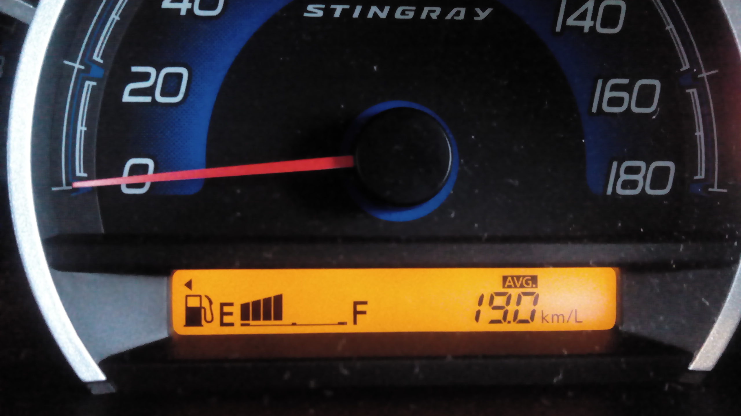

Currently I am getting average of about 19kmpl as shown in the display.
Yesterday got 19.5kmpl with a very light foot driving(5th gear, 60kmph).

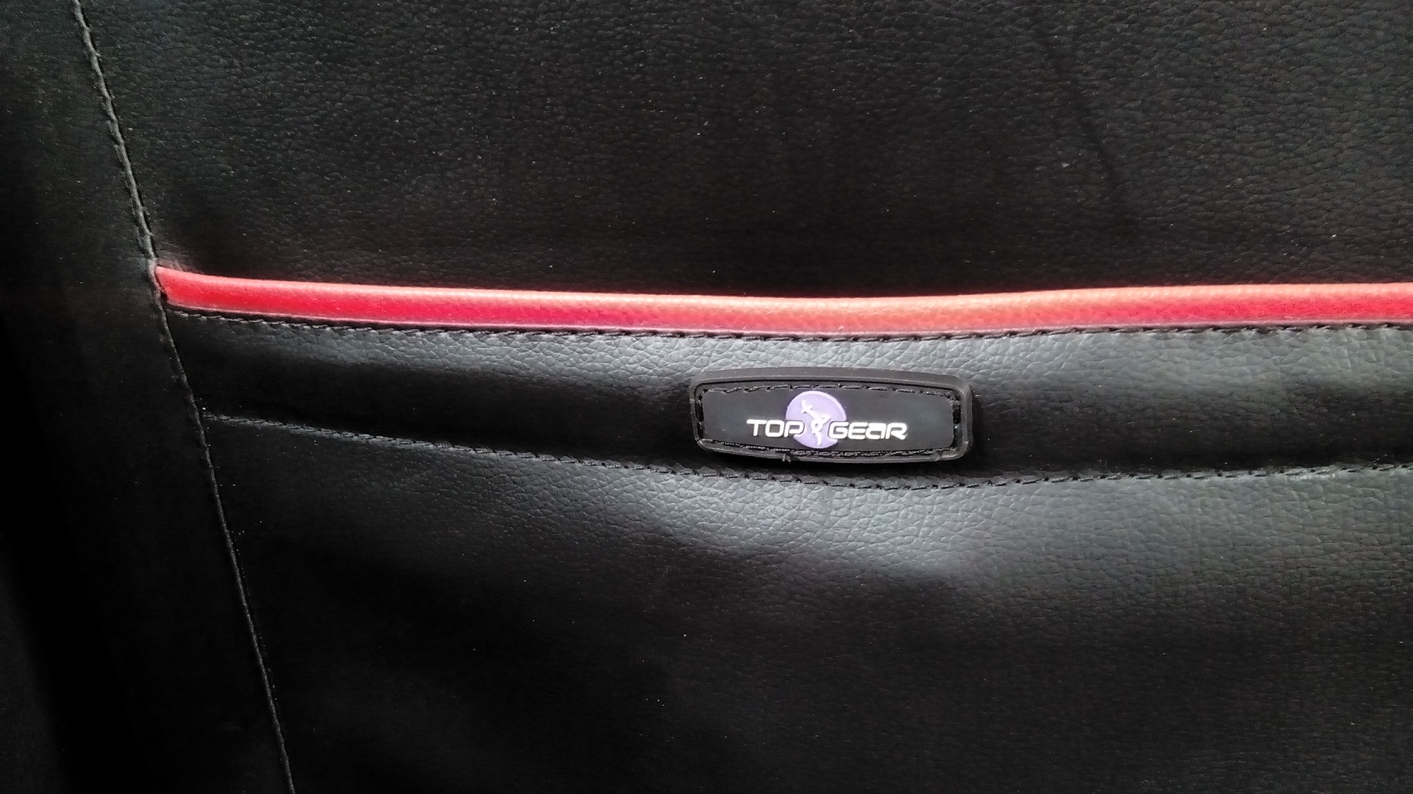

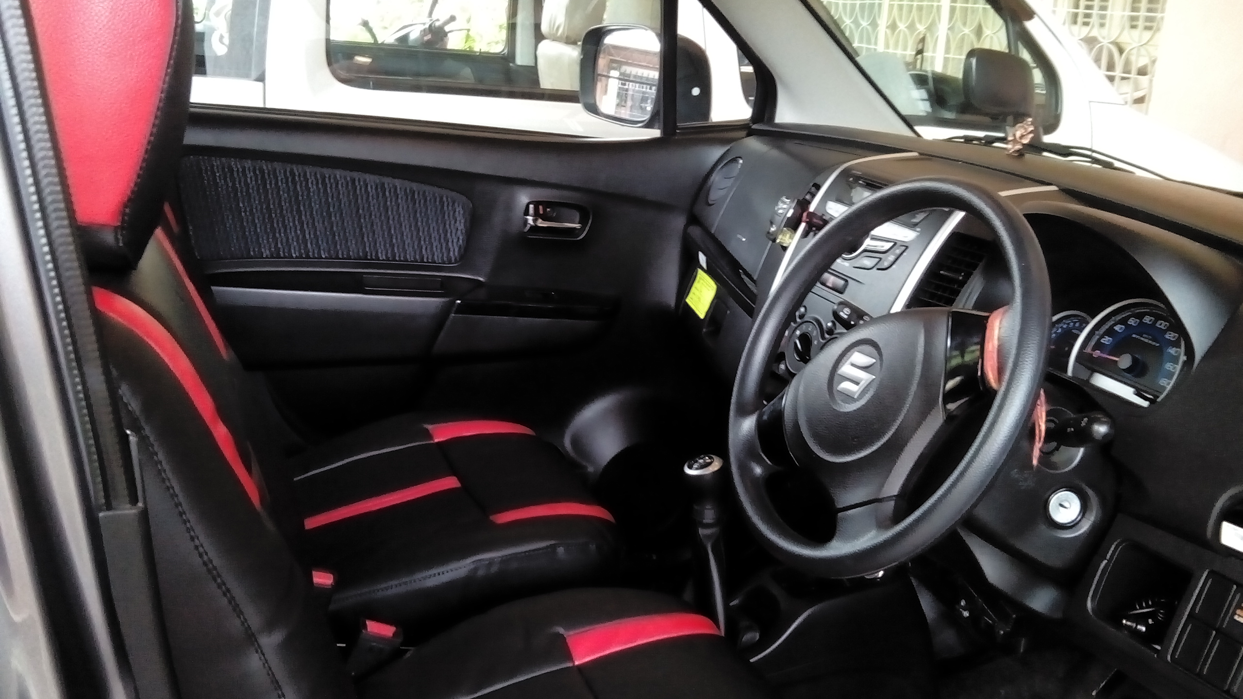

Yesterday after Office hours Wifey and me went to the local accessories shop to get new seat covers. The guy displayed all the options he had for Wagon R.
Found two of them to be of good design. First one was a black red combo(no red stitching which I would have liked even more) and the second was a black one with grey stitching. The second(brand Microline) one even had some padded area for back support and would have been great for long Drives.
However I opted for the black-red one as it was looking better and was from Topgear.
The boys got down to do their job while I asked the shop owner to fit the LEDs.
He first took out one Registration plate light and fitted the 28smd led but the light cover was not fitting as the light length was more. So he fitted another set that was with him(9smd led).
Seat Covers fitted:

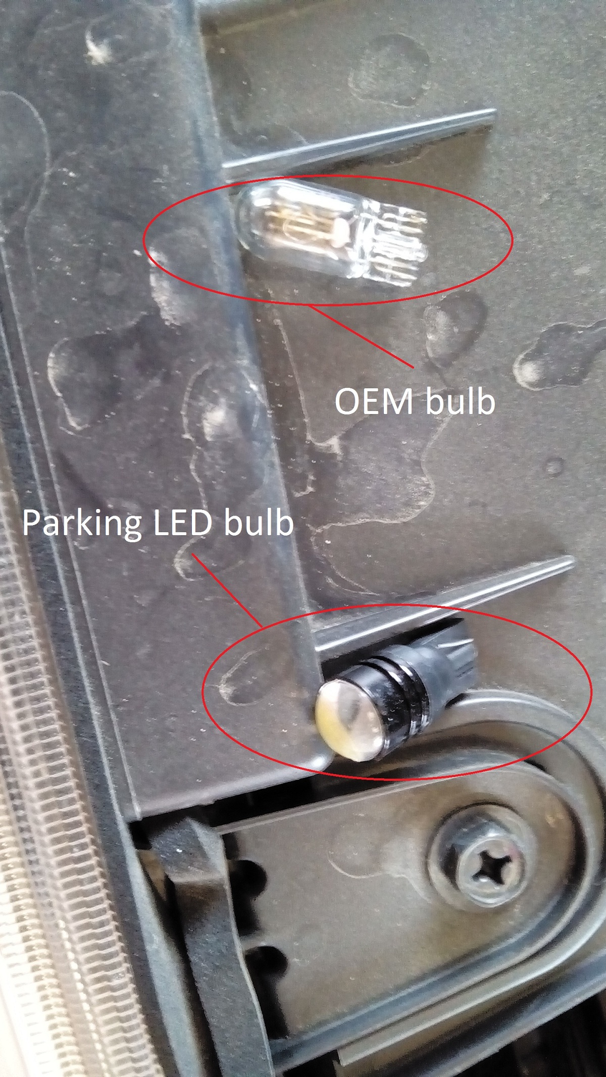

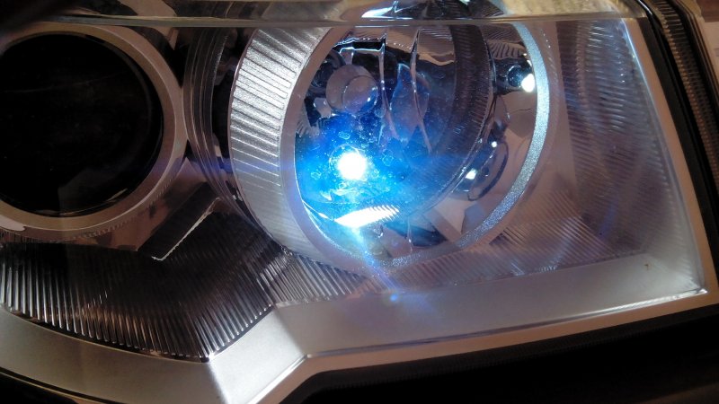

Today Morning got up and made up my mind to do some DIY and fit the lights myself.
Some pics:
Pic 3: OEM bulb and LED bulb
Pic 4: Pull the black rubber cover at the back of the headlight.
Pic 5: At the top is the connector for the high beam bulb and at the bottom is the parking bulb connector.
Pull it out and again pull out the bulb and fit the new LEDs
Pic 6: LED fitted and lit up

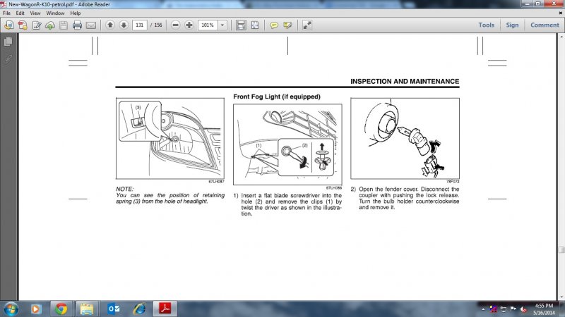

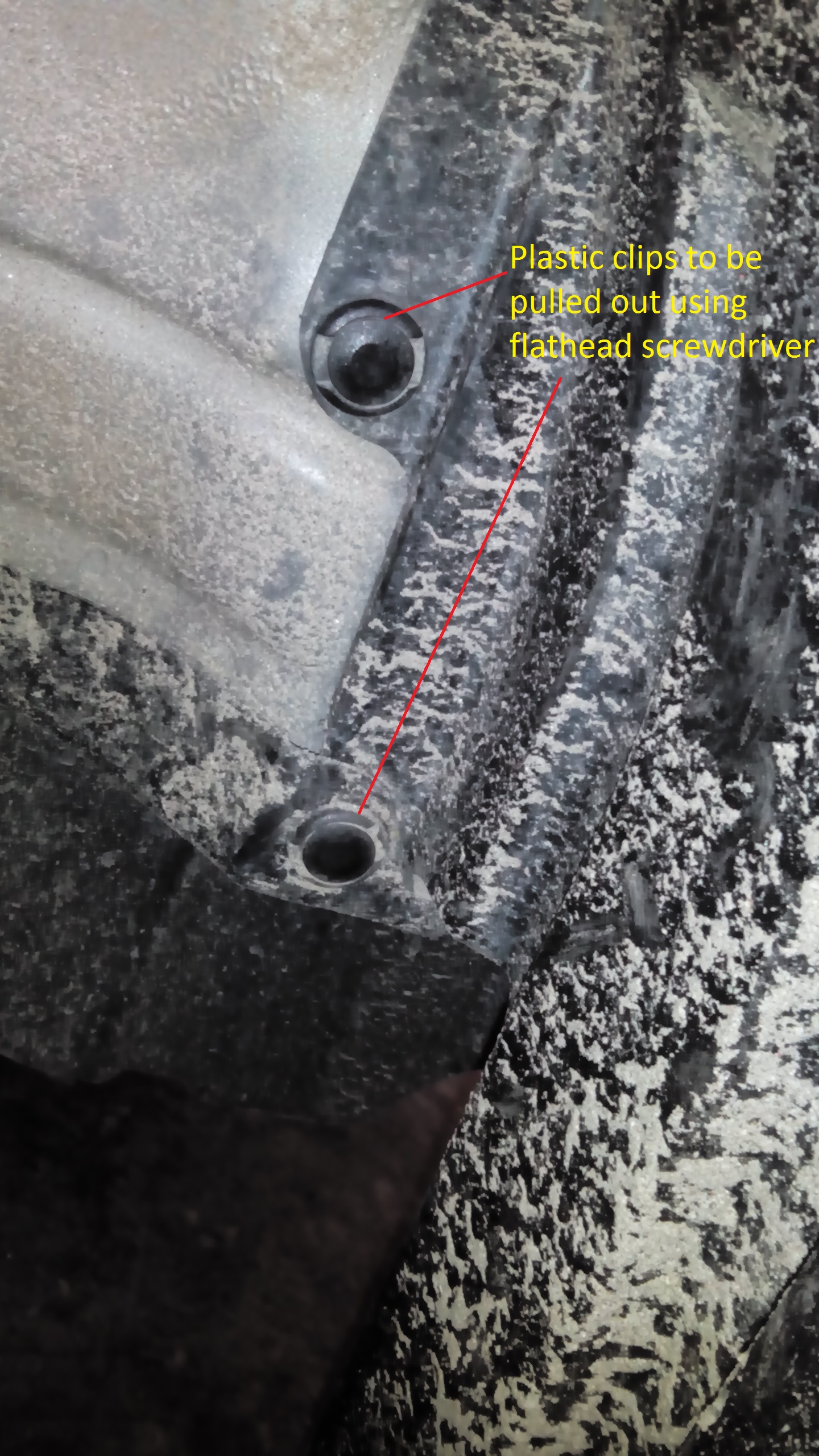

Now changing the fog lights:
Pic 7: Remove 4nos plastic clips by using a flatbed screw driver(2nos at the bottom of the bumper)
Pic 8: From the manual.
Pull out the clips and make some gap between the bumper and the black cover.
Pull out the connector as shown in the manual page. Rotate and pull out the bulb. Fit the new bulb and put everything back to place.
Pic 9: Parking and Fogs on.

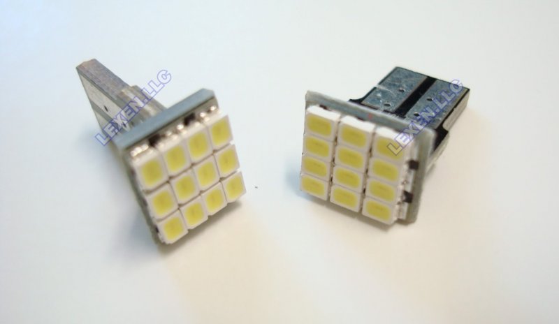

Pic 10: LEDs that went into Registration plate lamps(pic from google).
Pic 11: Removed the interior dome light cover in the way shown in the manual.
Pic 12: A similar light with less nos of LEDs(15nos) went into the interior dome light.
I managed to get hold of only one dome light for the front. Yet to source another for the back.

Could you please explain in detail, how you use trip meter(display) to show AVG.:stupid:
I am asking this as I haven't used it till date and would like use it and cross check with FE calculated with Tankful method.

Hi, tankful method is the best way to measure FE in my opinion.
Just push the small stalk on the instrument cluster and it will show different readings such as tripmeters, instantaneous FE, avg FE, DTE, etc.

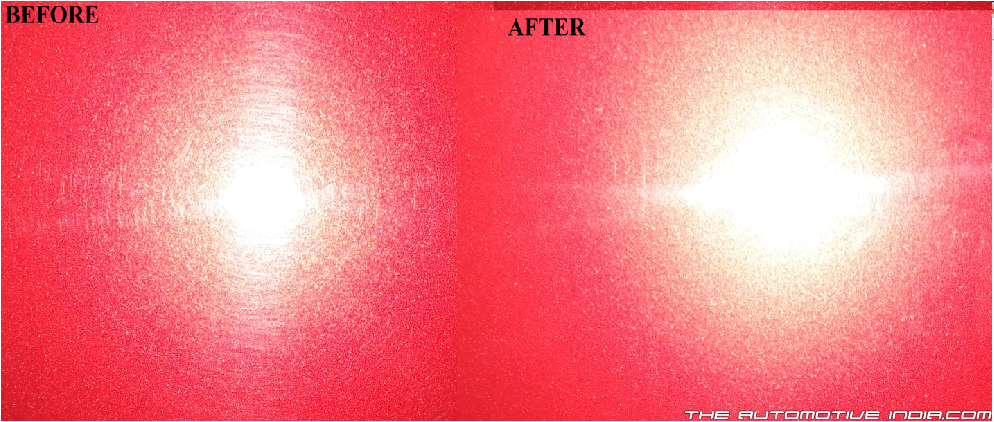

Sunday gave her for a wash and decided to polish her once back Home.
Noticed a lot of micro scratched which were not there earlier.
I think the wash boy's cloth/towels had sand which caused the scratches. I felt bad and couldn't do anything about it.[frustration].
my sincere suggestion
never wash car outside!!!
else say the guy not to touch car!
just water wash and dry it
never touch paint surface!
i always keep guys,families,friends not touching car. because in waggy outer clear coat is not thicker!!
even don't lyback over car while standing near to it
(i will sound strange but if you need glossy car for years here is the tip!!
buy a car washer!! must have!!
wash dirt off
then wash full body(from top to bottom)
then have a clean water filled with two small dove shampoo packets
mix well in clean hands
submerge the washer inlet to bucket
show the jet of froth coming from jet to body of car
this will remove any minute dirt!!
then within 3mins
wash off with clean water
let it dry'
use tissue paper to clean glasses
that's it!!
no cloth or hand while cleaning!!!
(do in shade or after 5pm)
will be perfect!!
shiny!!
