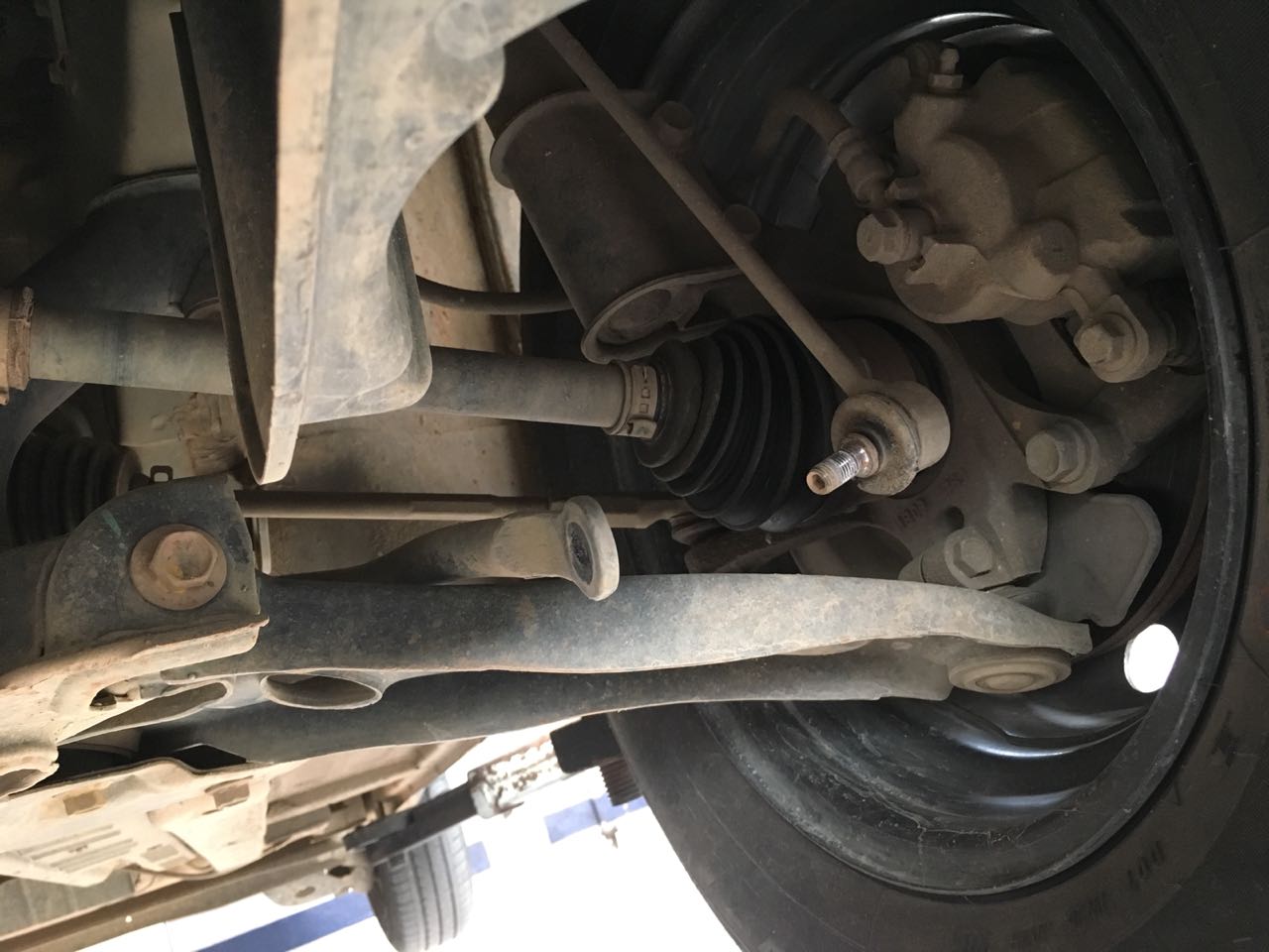

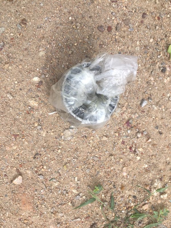

Finally took the car to maruti service yesterday and they did the OBD and found that the rear wheel bearings are the issue and also few other things changed. posting the pics for the idea that what all have changed along with the bill. they bought the car yesterday and parked at home in my absence, need to take a trial today and see how it behaves now. will post you once again about this later in the day
