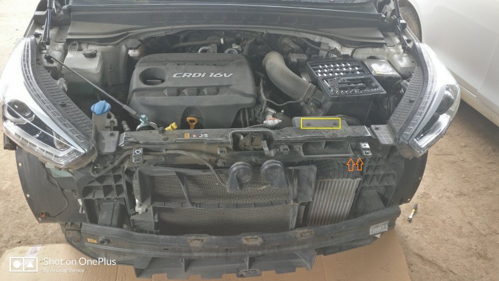

The intercooler fins will be coated in oil residue and the overall surface area available for the intercooler to work correctly will be reduced so indirectly the intercooler will not be able to work as required. Cleaning the intercooler at regular intervals say every 50,000 kms will help in the long run. On my Creta, I did the cleaning first at 35,000 kms and then at 75,000 kms.
The front bumper was removed to access the intercooler top mount bolts (as marked by the orange arrows)

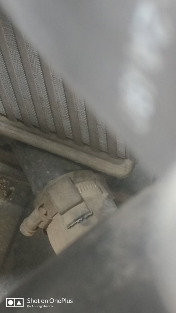

Bottom plumbing - Clamp to be loosened to remove the pipe. Access this clamp from the top is difficult so the best is to remove the plastic cover underneath and access the clamp
