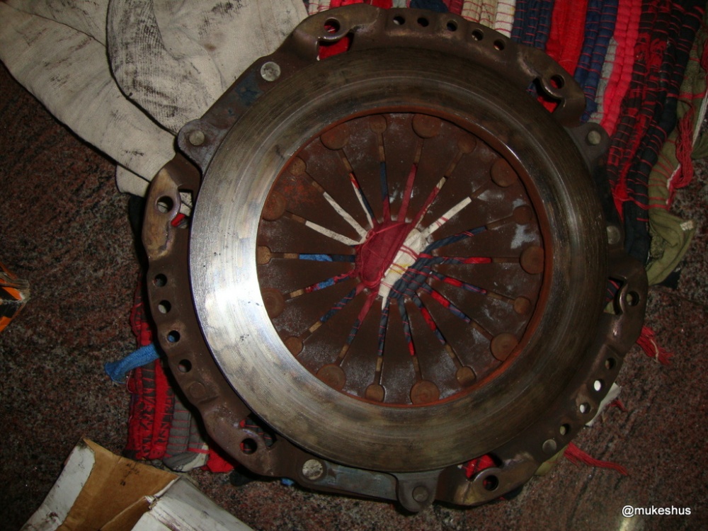

Here are the actual pics of Clutch plate, Slave Cylinder kit, Pressure plate, and Pilot switch,Clutch Release Bearing.
However as the Flywheel was covered under warranty, it was retained with them.
The Slave cylinder kit which holds the pressure plate, seems to have been manufactured on 12/03/2008.
But vehicle has rolled out from factory in August 2008.
Rolled out of dealership on 10/11/08, so exactly clutch system was 8 months old.
Probably made for Crde, as mentioned on the Pressure plate.
Pilot Switch
Pressure plate with Clutch plate above.
Worn out clutch plate, Good to go for another 500-700kms and would have failed any moment.
Pressure Plate
Shows pressure plate Manufactured in 12/3/2008.
