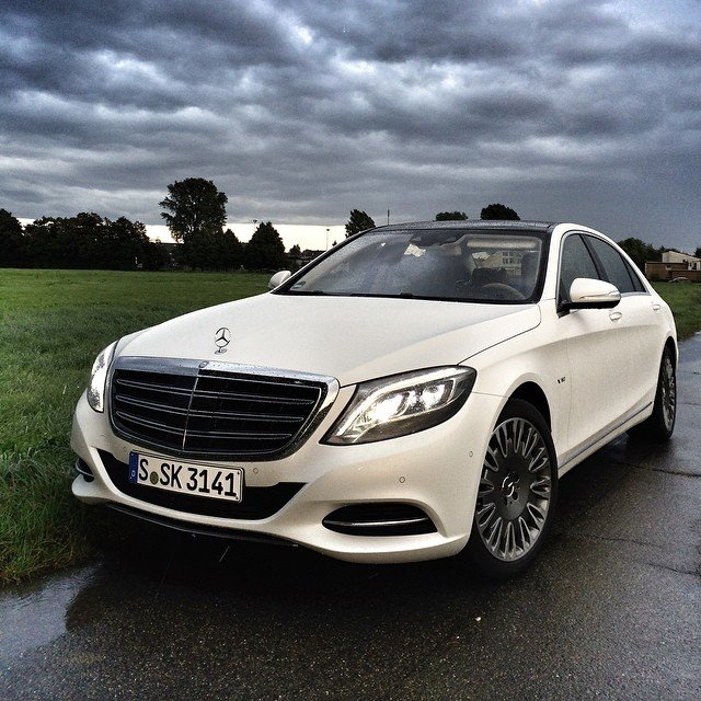

Guys i am about to upgrade my Hid bulbs on my igen I20 to better quality Osram bulbs,but before i want to spend money on my retrofit upgrade. I want to re-explore the idea of an Led set up for my projectors.I was wondering on a retrofit from a S class USA W222 without the complex variable led cos Usa model does not get it cos of lighting laws unlike euro spec.The mounts are damaged,everything is confirmed to be working,brand new it would cost me 4 lakhs to buy these lights.I was hoping by getting the whole light with the cooling system & ballast i could get a reliable set up.
I want brighter low beams,i am just doing a final thinking before getting the Osram hid bulbs.
But i feel i am being paranoid here & should explore a DIY led projectors myself? But i just love the way those projectors look,just so Bada$$ i cant help it.
My high beams run with 55watt halogen & the 35watt hid powered by the Denso ballast.The high beams are just amazing but i resist from flashing when overtaking cos its bad for the hid bulbs, thats why i feel LED with atleast 5000 lumens would keep me happy.
View attachment 174233 View attachment 174234
Hello Prads,
Its nice to hear of your endevour getting proper LED lamps in your Car. May I know whats your current car and what setup you run?
1) it appears you're running a chinese HID kit. If the KIT is 4300k, Upgrading to Osrams will give you a definite but hardly noticeable Difference. Human eye cannot pick an increase of say 10~20%. So better be prepared for only a subtle difference.
2)Now coming back to your retofit,
The first hindrance I see is cost. S-class merc headlights are going to be bloody expensive. I've seen BMW Headlights costing 3 lac for a pair. Thats as much as a small car in India!
Next hindrance you will have is the Sizes and Technical difficulties. I see that S-Class Headlight are much larger than your car's. These could not mechanically fit.
In the closing, I will say that LED headlights are not just some "Bulb and Ballast" that you can plonk into any housing. Acutally, the most important part are the lenses and Light guides (Optics) Which generate proper Beam pattern. It would be difficult to extract the Lenses without practically breaking them. As these LED headlights do not need Bulb replacement, They are entirely sealed units, and not designed to have any access to the LED of any kind.
3)prads,
good luck on finding cracked headlight housings. however before you spend any cash, do check if they come ON by supplying 12v dc. actually in most of these'super premium' cars, the lights are controlled by canbus and they won't even start unless Proper code is provided by car computer. for example your i20 ecu will not Power a BMW led headlights etc.
4) You have Halogen Highs then why would flashing harm your HIDs? Do Both Halogen+HID come on when Flashing?
5) If you are running 35W Ballasts, first try going to genuine 55W ones. They have faster startup, and about 4000 Lumens. (Compared to 3200 lumens on 35W ballast)
6) If you can bring things from USA, There are CREE XML u2 LED torches available. There are some crazy guys on CPF or HID Planet that combined 5~10 such torches and made a 10k+ Lumen monster. If you have access to Machining and Milling, you can do that. Cree XML 'TORCH" beam pattern is very useful as HIGH BEAM ASSISTS.
My current car i am planning this on is a 2012 igen i20,it has wider lights compared to Elite i20 & first type headlights. It also has separate reflectors for high beam & low beam,during high beam both bulbs turn on.This is how stock set up was.
Later i imported a Morimoto D2s kit from USA ,a projector lens was fitted to the low beams.This projector shield opens when high beam is used given an amazing high beam which works with the stock halogen high beam reflector.
Its using Denso ballast but one went kaput on install & was lost in transit for warranty claim.The Denso ballast is OEM Toyota supply,but same model has been used on Porsche OEM to Mazda OEM. One ballast is a local one at the moment.As was busy until now with work i am in final phase of ordering the single ballast & new Osram bulbs to replace the Morimoto bulbs. But giving a final think before spending.
3)prads,
I am aware these headlights cost alot but i already have access to a pair of damaged headlights for around 24k.The internals are intact & working but outer doom is a goner.
And even if i can play with the focus motors on the lens to get proper focus but i guess your right in process of opening these sealed units i damage one component then its a project gone bad.
Also on the canbus thing i am sure your right cos the cooling fans are controlled by sensors,it will be a difficult job to make things direct & i mite end up making things unreliable over our bad bouncy roads.
Yes both come on when flashing,i could only find a 10 second delay timer for the hid but i felt 10 seconds is too long to wait for lights to come on, i would be happy with a 3 second delay timer if i could possibly find one.
Yes but i am happy with the 35watts its just the bulbs that could do the upgrade,without going a bit too OT the bulbs use high quality expensive salts that give use illumination,so what we pay is what we get in HID bulbs, besides 55watt ballasts reduce the life of the bulb & in some cases bulbs do colour shift sooner. Seems like the better quality bulbs can keep it at 3500 lumens,but my wide projectors is making the low beams seem less bright when roads get more open.
That must be nuts,but to be honest i feel my high beams are already crazy enough,cos the high beam halogens were more like spot lights,thats what made me upgrade badly,the projectors in high beam is just brilliant as the shield is lifted. So both together with the amber light of the halogens and the 4500k light from the HIDs give amazing light. But then adding 10000 lumens must be an endangering but i still want it experience.[:)]
I can also add a tiny projector to my high beam reflector area & make it run in low beam & high beam giving double light output, so in such a case if i did led lights in them would be happy if i can get 2800 to 3000 lumens in them. It seems to be a viable option as cooling required will be less.
