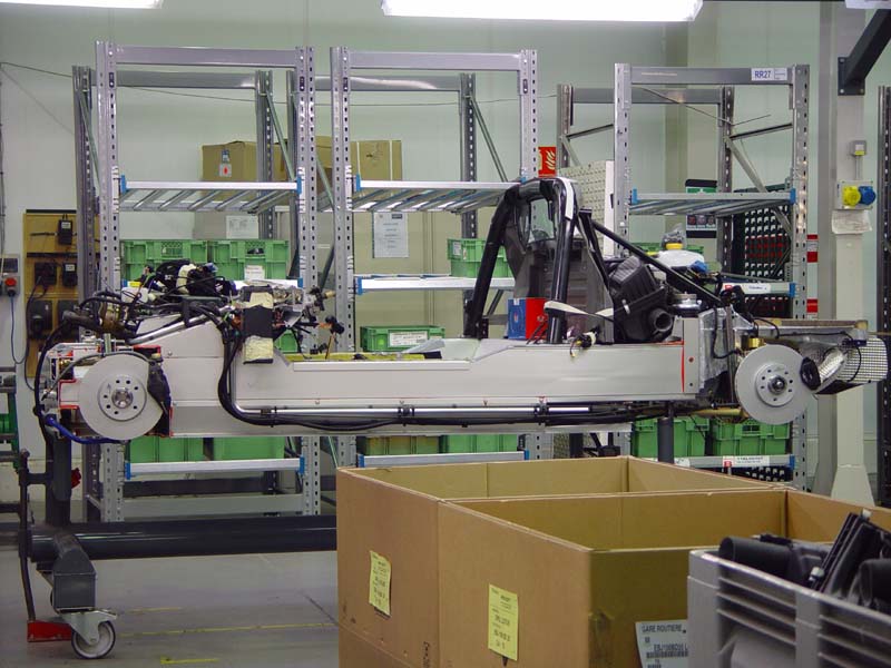

S1 Chassis
A little anecdote to go along with this. In 1995 during my visit to the London Motor Show at Earls Court I came across the bare S1 Chassis and was completely amazed by its design!!! Took a photo of it then and have still got it as a nice momento. At that point I hadn't even had a thought that I would be owning this piece of British design many years later!!
The Elise chassis is a remarkable piece of engineering. It's made from extruded aluminium glued (I believe it is aircraft glue) and riveted together to form an immensly stiff and light weight platform on which to build an open top car. The bare chassis weighs about 70kg and the rivets are only there to prevent peeling in the event of a crash. The chassis is suplied to Lotus complete by Hydro Aluminium.
The chassis is not designed to absorb impact during a crash and repair is a complex and expensive process, often resulting in a write-off if damage is sustained. On newer cars the chassis is sometime replaced but this is a time consuming process. The carbon fibre 'crash box' at the front of the car is designed to protect the chassis and driver in the event of a frontal crash. Trust me, it works very well! Within the various Elise Internet forums you may come across the term, 'chassis job'. This is a humourous (by British standards) reference to the relative ease with which expensive damage can be inflicted on the Elise.
The chassis side rails can get quite warm in the summer, especially on the right hand side. This is due to the pipes that run from the radiator to the engine, along the inside of the side rails.
Some pics. The red or greeny bits are actually the glue Lotus uses to bond the chassis. The last pic is a good view of the carbonfibre front crash structure.
