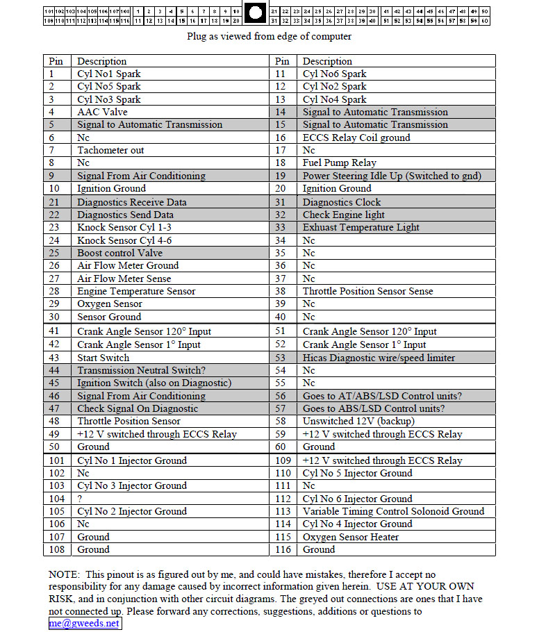

HICAS Diagnostic Codes 1989-1993
1 HICAS solenoid right hand
2 HICAS solenoid left hand
3 Cut off valve
4 Power steering solenoid
5 Vehicle speed sensor
6 Steering angle sensor
7 Neutral position sensor
8 (Auto) Parking brake sensor, (Manual) Clutch sensor
9 (Auto) Inhibitor switch, (Manual) Neutral sensor
HICAS Diagnostic Codes 1993-1999
11 HICAS control unit
12 HICAS motor power supply not present
13 HICAS motor output not present
21 Vehicle speed sensor not present
22 Steering angle sensor not present
23 Steering angle sensor neutral or not present
24 Rear main sensor input not present
25 Rear sub sensor input not present
31 Parking brake sensor input not present
32 (Auto) Inhibitor switch input not present; (Manual) Neutral switch input not present
33 Engine speed signal not present
