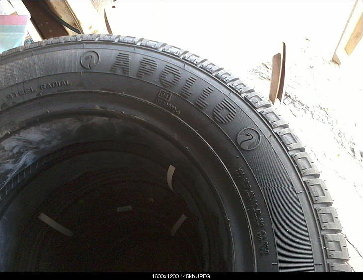

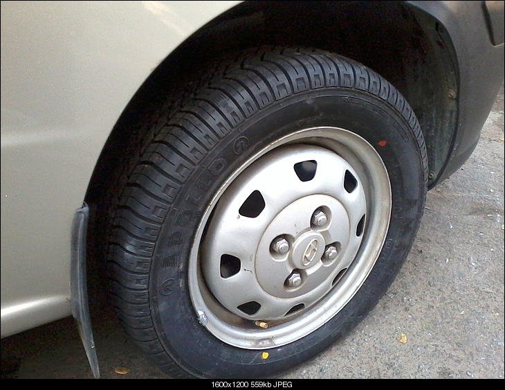

I wish to share my experience with regard to change of tyres on my Santro. The vehicle had clocked 43k Kms.
I changed the tyres (4+1) of my santro xing from 155/70R13 to 165/65R13 . Went to Hercules tyres in Seshadripuram. I enquired about the price of MRF (tube type) as budget was a constraint for me. He quoted Rs 2850/tyre for MRF but with 1 year warranty. He suggested me to go for Apollo Amazer (Tube type) as it came with 3 yr warranty. He quoted Rs 3000/tyre but bargained the price to Rs 2900/tyre.
He did not have the 4.5J rim for mounting this tyre. So for the time being i got the 165/65R13 mounted on the existing santro rims (13" x 4J).
The tyre dealer also took the old tyres for second hand rate (Rs 100/tyre).
The total bill amount came to Rs 14000. Rs 500 was charged for wheel alignment and balancing.

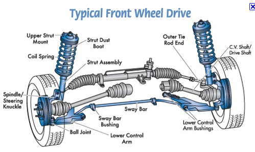

i10 at 71700 kms.
front portion of the car used to make noises everytime the car went into a pothole. so after consulting the mechanic got some parts changed.
* Ball joint
*tie rod
*arm bush
refer image below
the parts costed 1200 rupees plus 700 rupees labor.
and there is no more noises in the car [:D] completely rattle free.
