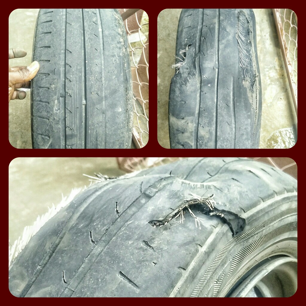

The GREAT Escape - Front left tyre BURST
Intro :
Went to Kulanjipar Temple as planned & then had an unplanned visit to Navaladiyan Temple in Mohanur (near Namakal near Salem). The entire journey was done around 80 kph except for occasional rise to 120.
While returning from Namakal, as I joined the 4 lane after 8pm, started feeling a mild kud-kud sound coming from car. A quick inspection revealed nothing. All tyres were fine & nothing loose. As I drove on started realizing the PULL TO LEFT. Also, the volume of kud-kud increased, if speed went up. One again rechecked ; nothing visibly bad. Dropped speed and drove on. Stopped at Thopur A2B for dinner and checked tyre pressure. 3 tyres were at 32 & rear right was at 31 psi. Nothing unusual.
But, found EXCESS TYRE WEAR on the front left. It was 9:40pm and with 180 odd km to cover, decided to drive on. Avoided ALL drama on the hectic Krishnagiri-Bangalore stretch and dropped speed to 40-50 kph. Finally reached Bangalore and reached New BEL Road at 12:35 am; within 7-8 km of home.
I slowed to climb a Road Bump. At 10kph, the front left tyre BURST. Just opposite to CPRI Colony. On a fully lit road section. Gods were working over time to save me and my family. It could have happened ANYWHERE when I was surrounded by trucks. Trouble was due to wheel alignment problem, I guess.
Parked it safely in the side, changed tyre and reached home safely.
Will upload the tyre picture later.

Photo of the BURST tyre
Some pictures of the BURST tyre (in Red collage) and other four tyres (in Green collage).
See how bad the BURST tyre got worn out compared to other four tyres.
Today, drove for about 100m with hands off the Steering and the car went ... ... ... Straight. Me confused. BTW, taking car for Scheduled service tomorrow. Will see the results of Wheel alignment.

Re: Hyundai Fluidic Verna 1.6 CRDi EX: 50,000 Kms Update
That tyre didn't have any tread left. Shouldn't have used the tyre for so long. Get it changed around 40k and 45k max.
The other tyres too are not in good condition. Change them asap. Try yokohama earth1.
