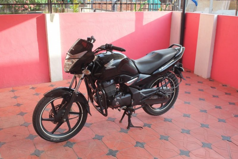

Ownership Report:-
Bike has till now clocked 30k in 4 years time with me. I am the sole user of the bike and it has been a totally trouble free experience for me. Did all free service at the dealership but didn't do the paid service. Did the rest of the service at a local shop near my place were i knew the mechanic very well.
Engine and Gearbox:-
The most refined engine in 150cc bikes with good linear power delivery is the highlight of Unicorn's engine. Has adequate power to cruise in 80km/hr without much fuss. The 5 speed gearbox with 1 down 4 up universal pattern works like a charm. I have never faced any issues in this department and i am totally happy with this.
Suspension:-
Mono suspension works well and in it's stock setup is tuned to be soft which i like as i am not an aggressive rider. Sharp potholes do unsettle your back but if you are a bit careful then it won't be a big issue. Overall i am happy in this department also.
Brakes and Tires:-
I am not happy with the feedback the brakes provide but my riding style never warrants emergency braking as i usually cruise round 40-60km/hr mark. I am very happy with the stock MRP tires. Even after 30k in odo there still quite a lot of thread in both front and rear tyre. My mechanic says it can easily go upto 60-65k.
Maintenance Costs:-
Regular servicing in 6 month interval has kept the bike with very low maintenance costs. Periodic oil change at 3500kms and fork oil change and front brake pads at 15k mark is all that was required. I have never changed my rear brake liner and it still never makes a sound even under hard braking.
At 18k did change to fully synthetic oil by ELF and mechanic told me to change oil only after 7k even though the oil manufacturer claims 10k is the interval required. I have covered 12k after oil change, mechanic found the oil to be ok to my astonishment but i will change it in my next service visit.
Mileage:-
Have always returned stable mileage and has been very very happy in this department.
In city- 55-57km/ltr
In highway- 61-64km/ltr
Please note my riding is unlike most young guys as i ride very sedately in 40-60km/hr range (which is why i think i get good efficiency) and also i wear premium helmets from LS2 as safety is prime consideration while i ride.
Some of the pics of my bike are attached with the thread.
