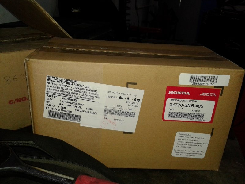

Friends,
Finally the airbag inflator of my CITY IVtec (2011) has been replaced FOC under Honda's recall. The entire job was done at Crown Honda and it took about 25-30 minutes for the work. In 1 hour I was out of the workshop and the job has been done to my satisfaction. Big Thanks to Honda and equally big thanks and regards to The Automotive India & CRACING. As promised, WIP pics are attached below with all necessary details. I am immensely relieved now!!

Thanks for sharing Sirji. [clap]
So only the driver side inflator is replaced? And there is no issues with passenger side air bag?
The replacement kit looks pretty big though.

I asked the technician buddy, he said passenger one does not have issue in this affected lot and major issue was driver side airbag inflator.
