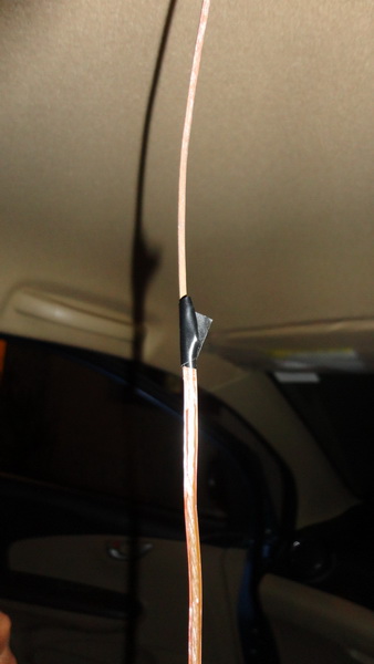

Remove The Dome Light Glass
Unscrew The Whole Dome light Compartment
Unscrew the Door Sensor as we are connecting the door sills to the sensors
Thick Wires were used for better safety and insulation :)
Removing Side Beeding For Routing the wire
Wire Inserted through the dome light Compartment for routing
As the wire alone didn't make it's way to the side beeding a thick steel wire was used to tie the wire and pull from the side beeding to route it towards it :)
Finally Wire is routed through the dome light compartment to the side beeding :)

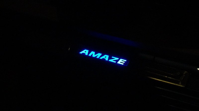

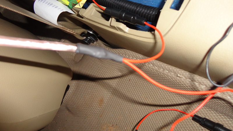

The Door sills came with inbuilt Fuse compartment,so no extra work was needed from our side to protect the whole circiut :)
Sleeves were inserted to prevent the wires being cut off while routing it through the side beeding

Connecting the wire routed via dome light to the sill wires and connected it with sleeves, secured [;)]

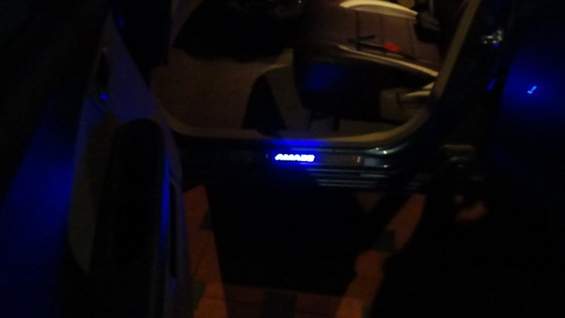

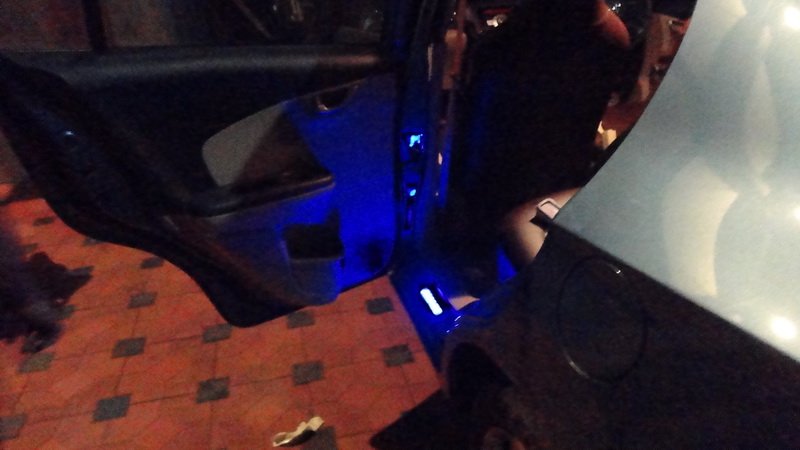

Fixing the Door sills [clap]
Putting the door sensors back and Screwing it [;)]
Similarly Do the same for the rest three doors

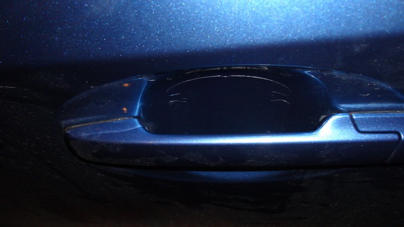

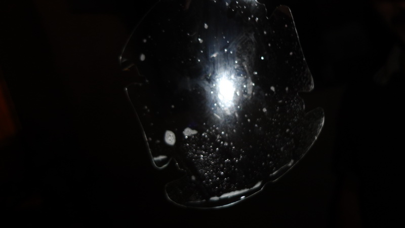

DIY 3M Clear Door Handles Paint Scratches Protective Film
Got these 3M Readymade Stickers from Ebay
HONDA AMAZE 3M Clear Door Handles Paint Scratches Protective Film | eBay
Remove the stickers and apply Colin in it to avoid Air bubbles while sticking
Gently Place it on the Door Handle Scoop and Slowly Squeeze out the Colin from it using a microfibre cloth
Finally The stickers have been Placed [clap]
