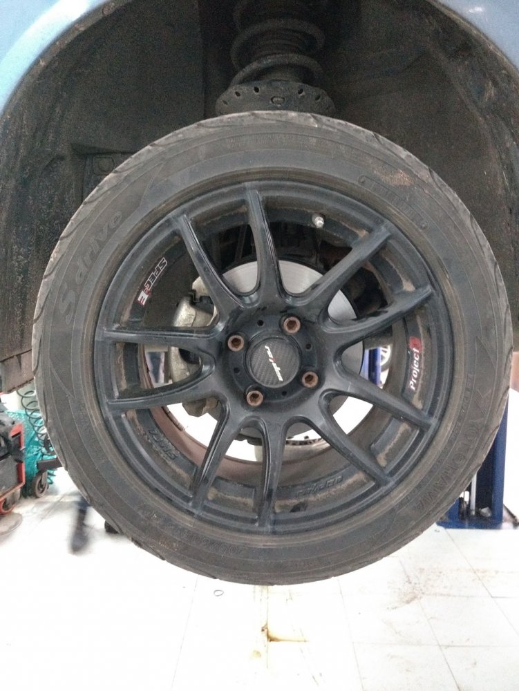

84K on the odo and it's time for another set of brakes pads to go in.
Skimming the stock rotors for the last time. Have skimmed them for the first set of pads and now. Will change the rotors along with pads on the next change.
Almost done.

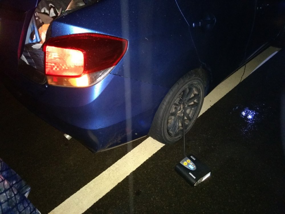

Was coming back to hometown after a quick visit to my native. It was around 11:30 PM and was raining cats and dogs. It was a heavy downpour and the car was fully loaded. I was wading through water at times and I started to notice smoke coming from the right rear end. Stopped and to my shock, I was driving for the past a minimum of 10 minutes with a flat tire and it heated up pretty badly and what I saw was steam and not smoke. Stopped the car. Took my air pump and inflated it. Around 25PSI, I suddenly started hearing a hissing noise and it kept on until I stopped the pump and all the air was out. Tried to locate the leak and it was on the inside edge sidewall. This was one of my biggest fear, because it was late, I'm with my family and emptying a fully loaded boot at the night in drenching rain was something next to impossible. Anyway swapped the spare tire and started back the return leg.
Something pierced through the sidewall. I remember falling into a deep pothole filled with water, but this was scary.
Taking it to the nearest tire shop the next day.
Without the Lenso's, Amaze looks really sad.
The Yoko's were almost up for a change say like around 10K life was left. So patched up the sidewall since I don't want to get a new tire at this time instead I would change all the 4 if it successfully lasts till then.
All cleaned up.
Swapping it back. No problems whatsoever until now.
