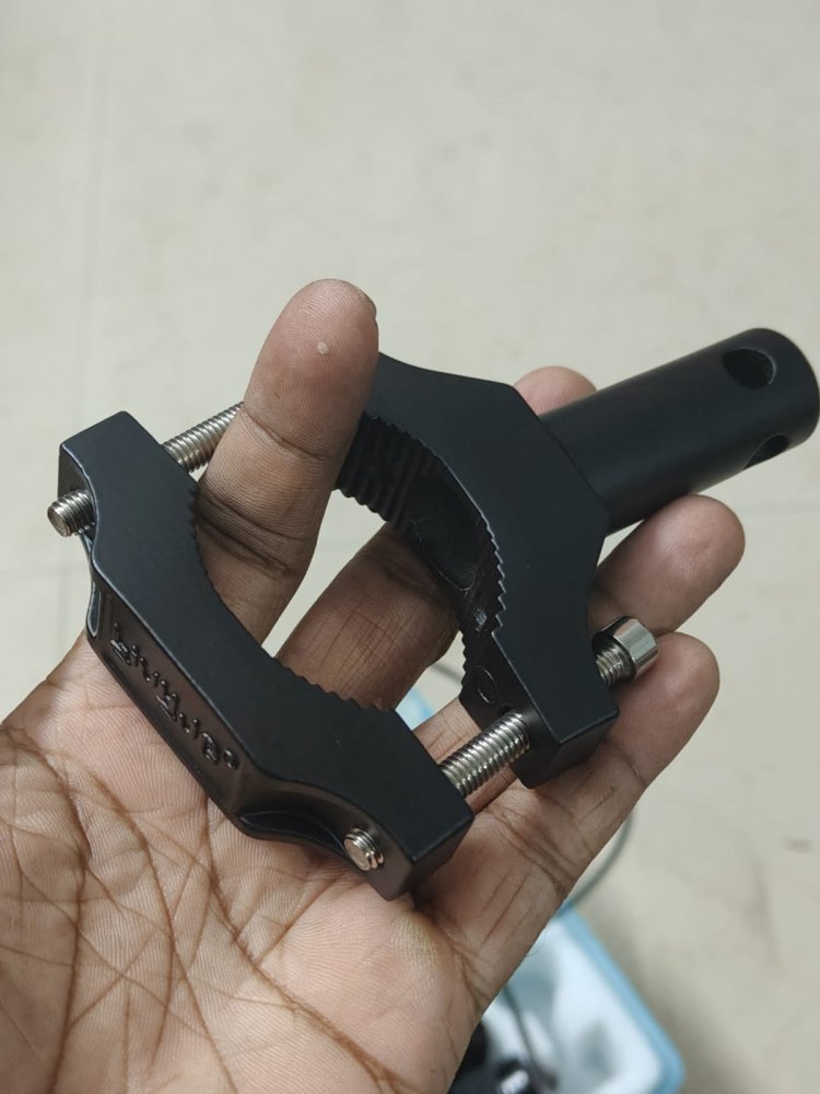

I found out that there are so-called aluminum fork clamps which were manufactured by Chinese manufacturers.
Price 850/pair.

Price for the clamp. Rs450/pair.

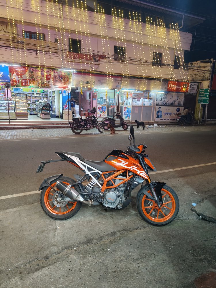

The newly added fog light is barely noticeable from the side.
