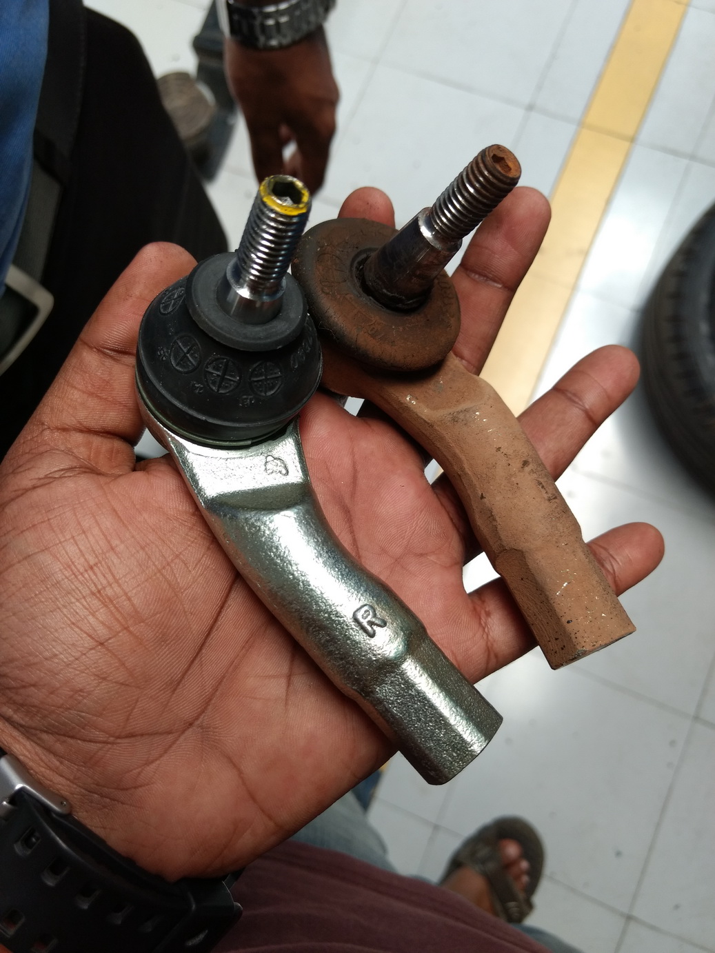

The tie rods were up for a change since few weeks, I have been busy with some errands around and that's why it was kept on hold. Recently the metal clattering sound really started to annoy me and took it to Harry Ford on Friday.
Lifted Up and Tie Rods detached.
Kaput Tie rod
New Part
See the Difference [cry]

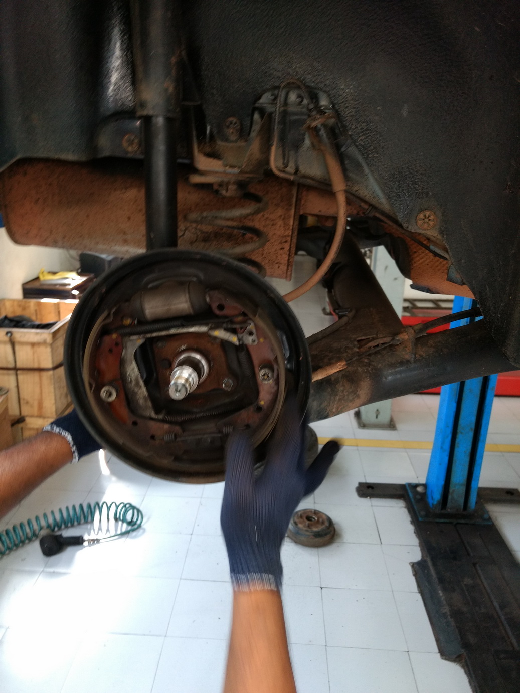

Rear Drum was making noises, Opened up to check the pads , Cleaned it and refit back.

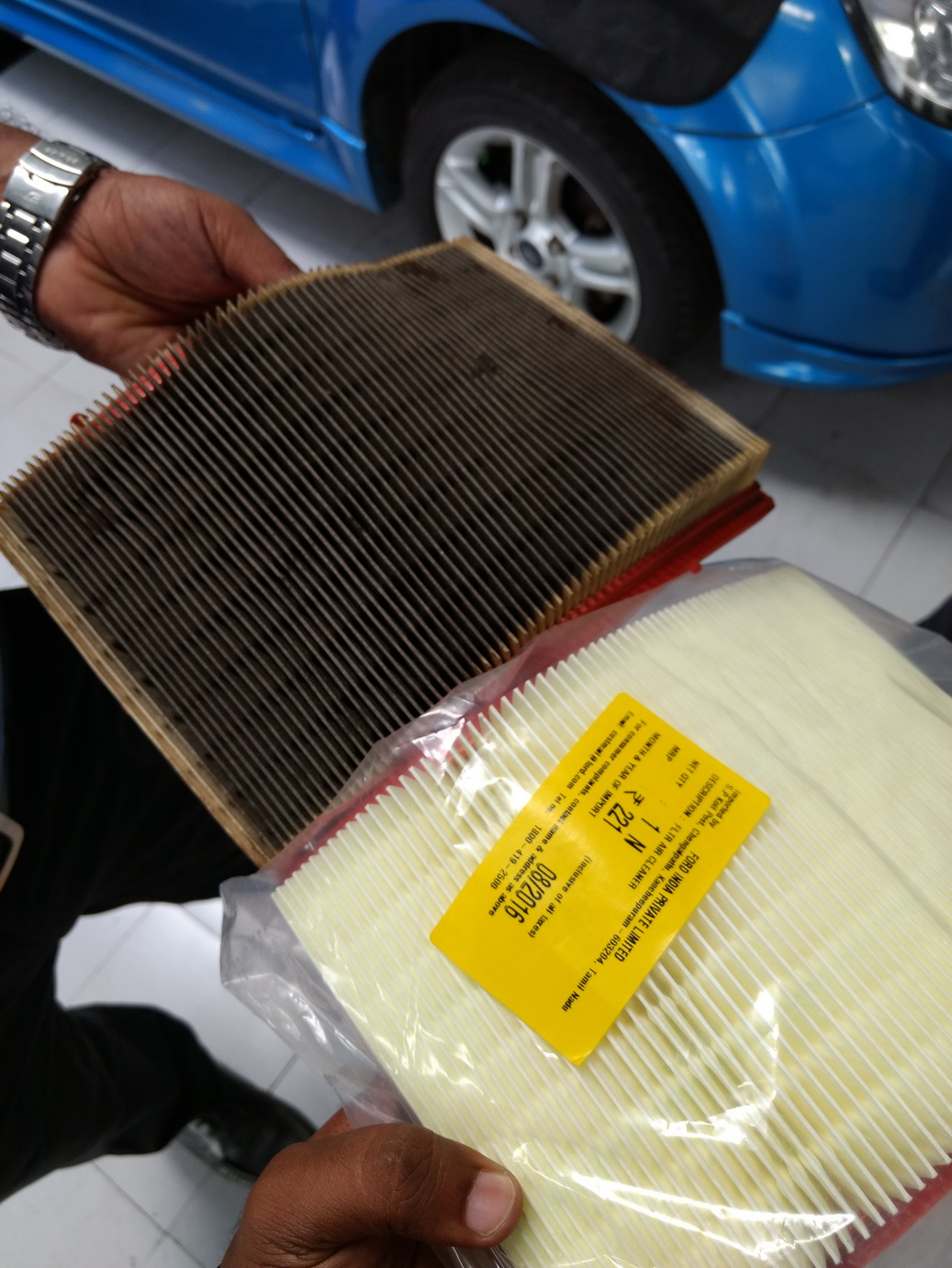

Opened up to check the air filter.
Tiresome job comparing the fact that almost all cars have clips holding them and don't need to remove the whole AF box and then unscrew 6 bolts[lol]
Dirty and Clogged up.

Took the car for a quick drive yesterday night and straightaway there is a massive difference in the pull and the power band feels so strong and engine pulls much more freely. Thanks to the new clean AF. The metal clattering sound of the Kaput Tie rods is no more and the car feels a bit more connected.[clap]
